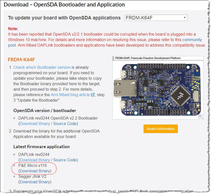

Please update the P&E Micro v118 firmware application for on board OpenSDA debugger.

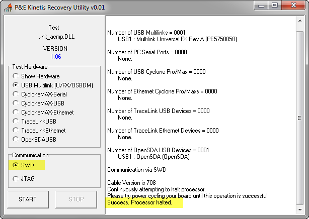

And then use the Kinetis_Recovery_Utility halt K64. For more detail, please refer: Bricking and Recovering FRDM-KL25Z Boards: Reset, SWD Clock and Low Power.
Hope that help! Have a nice day.
Robin

davidsherman
Senior Contributor I
Hi Deepak and Robin, sorry for hijacking but I've run into similar problems with my FRDM-K64F.  I plugged it into my Windows 10 laptop and managed to corrupt it in fairly short order, then discovered the problems with Windows 10.  I have followed the instructions Robin provided using a Windows 7 computer, but I'm a little confused.  I seem to have updated the bootloader with the Daplink bootloader, because now if I plug it in with the reset button pressed, it shows up as a drive labeled "MAINTENANCE" instead of "BOOTLOADER", and according to the text file it is version 0244.  I downloaded the P&E drivers, and if I install "DEBUG-FRDM-K64F_Pemicrov108a_for_OpenSDA_v2.0.bin", it shows up as a Pemicro OpenSDA debugger under Jungo devices in Device Manager, which allows me to program and debug the K64.  However, it seems that to use it as a mass storage device AND debugger, I need the .SDA file "MSD-DEBUG-FRDM-K64F_Pemicro_v114.SDA".  If I start it in bootloader mode and copy that file into "MAINTENANCE", nothing happens.  If I unplug it and reconnect it normally, I don't get a mass storage device.  Am I missing something?
