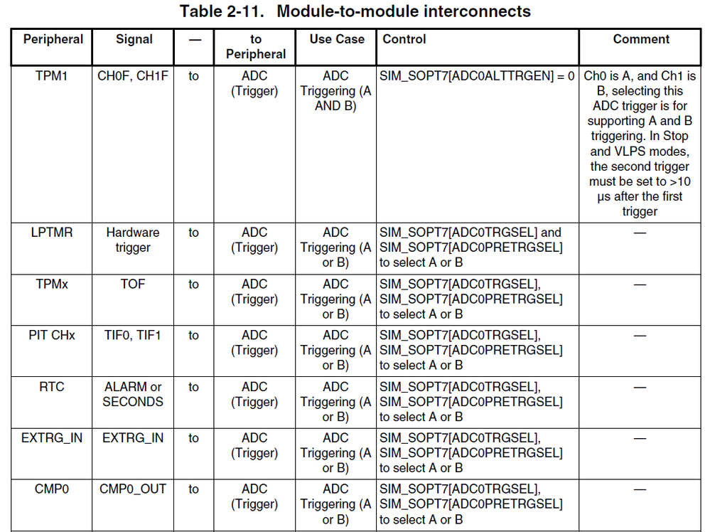

I have ADC reading issues on the SE6b and SE7b on NXP MKL27Z64VFM4(QFN32). The other channel reading is fine after I connected PTE30 to Vcc. Does somebody know how to get hardware trigger and reading the correct ADC value?

For HW triggering just read the manual since it tells you all you need to know about sources and trigger selection::
There is an example of PIT triggering in appendix A, paragraph B and of TPM triggering in paragraph E (this allows variable A/B HW triggering).
Paragraph D explains input mixing fundamentals that are needed to be understood to correctly to use 'parallel' A/B channel triggering and a/b muxing.
If you have problems with (just) SE6b and SE7b inputs it is not a HW triggering issue but incorrect input channel muxing (again paragraph D explains this, which is why I pointed it out). These inputs don't need HW triggering - they can be read in SW mode as others that you already have working.
Notice the a/b and A/B notations used since they have DIFFERENT meanings.
Mark
