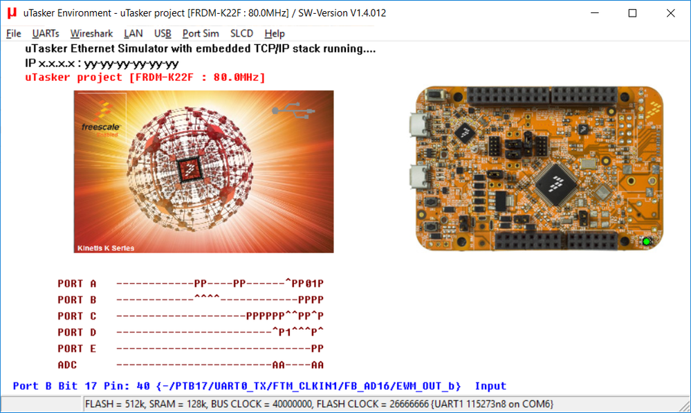

I have attached a binary for the board showing it in operation plus a simulation (unzip the attached and start the simulation with a double click on uTaskerV1.4.12_FRDM-K22F_ButtonTest2s.exe. When it runs it looks like below and you can click on the button to hold it down and see the LED reacting (same as on the HW).
