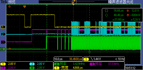

       One of my key customer is using DSPI1 to read extern flash, now they meet one problem, they want to read flash content via DMA,but SPI1 has only one DMA request source number for Transmit or Receive, so they send the flash command manually(without DMA), then enable DMA and set CONT_SCKE to generate continuous SCK signal to read flash,DMA can't get any data, the buffer is empty,We use Oscilloscope to observe wave, we can find the data from Flash;If they sent the dummy data( CONT_SCKE is clear) manually and received data using DMA, it is OK. I don't know if there is any error on SPI setting and DMA setting, or K21 can't support the usage? Thanks

For picture:
Green: SCK
Blue: MISO
Purple: MISO
Yellow: CS

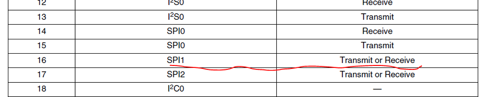

fredfu
Hi Ping,
    Thanks you for your infromation.But my problem is difference with the ref., my customer use DSPI1, DSPI1 has only one DMA request source number for Transmit or Receive, I can't use one DMA channel for transmitting and another DMA channel for receiving.

fredfu
Hi Ping,
    It is now being used in ways, because  DSPI can't use DMA to transmit when DAM for receiving, the efficiency is low. Now they want to improve the efficiency, they enable CONT_SCKE to generate clk for flash(you can see the source code),then DMA for receiving, but DMA can't get any data, I want to know if K21F can support the way. Thanks.
