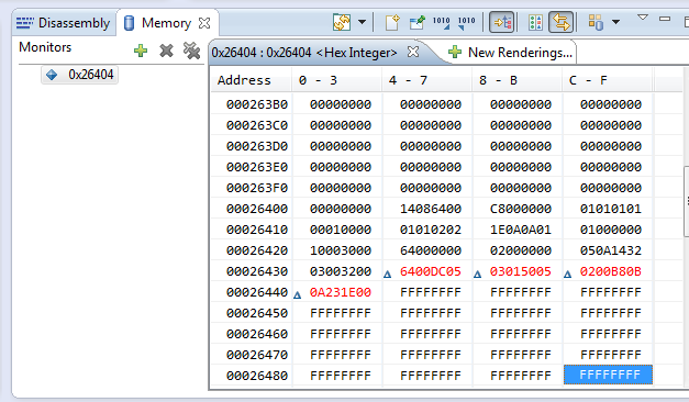

When the bootloader have to flash the bold line above, the problem occurs.
Debug:
Until the address 0x26434 the flasher is ok
The image below shows what happen when it flashs the address 0x26444
Then the CPU stops and goes to:
PE_ISR(Cpu_Interrupt)
   /* This code can be changed using the CPU component property "Build Options / Unhandled int code" */
   PE_DEBUGHALT();
Attemps to solve the problem:
I reduced the code to check if the problem occurs just in this address (0x26444), but the problem occurs in others address too, but always when flash the datas of the line (0102010101010264FFFFFFFFFFFFFFFF)
Does anybody have idea what can be happen?

The K22FX512 user phrase programming (8 aligned bytes at a time). You show 0x26440 programmed betfore the line starting at 0x26444, which would be an illegal operation (it is not allowed to program the first phrase again with a different value since it damages the flash and generally causes the sector to become unreadable [with hard fault later]).
Therefore you need to store the value 0x0a231e00 which is to be programmed to 0x26400 until you get the start of the following line (the 0x01020101 for 0x26444) and write it as a single phase of 0x0a231e0001020101).
In case of difficulties, copy the SREC loader from the open source uTasker project (links below - document http://www.utasker.com/docs/uTasker/uTaskerSerialLoader.pdf) or its flash driver interface which handles all such details.

engenheiroeletr
Is there a way to configure CodeWarrior to generate srec file with 8 aligned bytes?
All srec file is aligned, but just in the end it is changed.

mjbcswitzerland
Specialist V
You could write an SREC to SREC conversion program that ensures alignment but it seems a poor engineering solution. It is better to correct the loader problem (flash driver) rater than require a non-standard input to be required (it only takes a few lines of additional code to buffer unaligned content until it can safely be committed).

engenheiroeletr
Thanks mjbcswitzerland‌. I solved the problem aligning the 8 bytes before flash them.

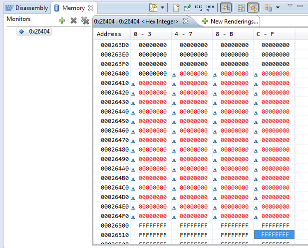

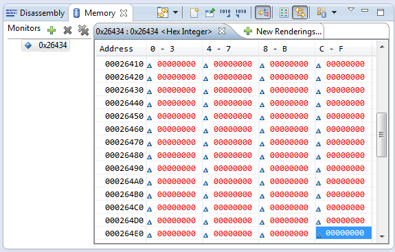

 2. If you have interest,     I think you can try to modify: 0102010101010264FFFFFFFFFFFFFFFF to other data, especially modify FFFFFFFFFFFFFFFF, you can modify some FF to other none ff data, but at last, you also need to calculate the correct checksum data, checksum = NOT(length + address + data).
Instead modify the line, I erased it, Then the problem happend in the address 0x2646C. Please see the images bellow.
