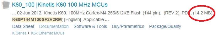

I have downloaded 2 versions of K60P144M100SF2V2RM Rev.2,
one is 14.229KB big - another only 13.853KB !
(they seem to be the same... but who knows - I'm not going to compare page by page...)
So how can it be ???
A version is A VERSION and should have always the same size (at least in my opinion) !

3) Could you please point me to the site where you got the manuals?
In our official NXP website I can only see one file for K60P144M100SF2V2RM.pdf:
K60_100 |Kinetis K60 100 MHz MCUs|NXP
Maybe you also downloaded the Reference Manual K60P144M100SF2RM.pdf. This is for an old revision of the K60_100 MHz silicon.

Ad 3)
Of course I've downloaded K60P144M100SF2RM.pdf also - in other case I couldn't report the  problem in point 2 !
All downloads were done from the NXP page.
But the best comes now - I've just downloaded K60P144M100SF2V2RM.pdf from NXP - link:
http://cache.nxp.com/files/32bit/doc/ref_manual/K60P144M100SF2V2RM.pdf?fpsp=1&WT_TYPE=Reference Manuals&WT_VENDOR=FREESCALE&WT_FILE_FORMAT=pdf&WT_ASSET=Documentation&fileExt=.pdf
This time it is 20.5MB big !! - despite that you see:
So I have now 3 Versions:
      14.229KB - downloaded 2014-03-05
      13.853KB - downloaded 2016-02-10
      20.502KB - downloaded 2016-03-31
When you open these files in an editor, you see that the content is different - one can only hope that the pdf view / printout will be the same - but nobody can check it page by page...
