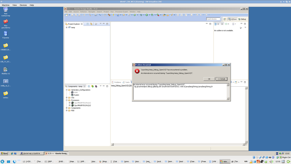

After a fresh install of KDS3.0.0, everything works. Once I do a software update I can no longer debug.
I have tried starting a new work space and that doesn't help.

After trying to start debugging error message, stated on the screenshot.

I can reproduce that problem on my machine: using the latest GNU ARM Eclipse plugins causes J-Link and QUEMU to fail. I have filed a bug ticket on SourceForge and contacted the maintainer directly.
https://sourceforge.net/p/gnuarmeclipse/bugs/192/

Yes, I use a 64-bit Linux.
In Windows XP, these same problem:Screenshot - 08042015 - 12_01_23 PM.png

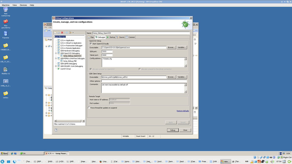

I use a bunch Openocd-GDB for debugging other families mikrokontrollers in KDS3.0.0 - there is no problem. Problem arise when i use Kinetis microcontrollers.
This is a topic where the problem went: https://community.freescale.com/message/535933#535933
When installing without updates KDS3.0.0 under GDB debug server is not running. After updating the KDS - do not run the appropriate plug-in Eclipse. The screenshots setting Openocd session under Linux and Windows.
