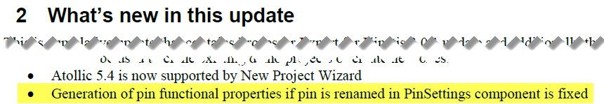

Jorge_Gonzalez
Hello Rob:
Marek is correct, this was an issue with Processor Expert that was fixed in the update Processor Expert for Kinetis 3.0.2. See below from Release Notes:
Indeed you can install KDS v3.2. Or you can try to install the Processor Expert for Kinetis 3.0.2 update in your current KDS version (Help -> Install New Software -> Freescale KDS Update Site):
Regards!

robbolton
Thanks, I was able to update and found you were both correct. Other pins that I had renamed as well are now having their pin functions generate correctly.
