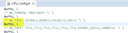

In that blog Erich recommends to set the FSEC byte (not bit) to 0xFE. As you can see in the same blog, you have to set this in the Flash Configuration Field value as showed with the pictures.
- For a project with PEx + KSDK: You will find this configuration in the file startup_MK64F12.S:
- For a project with only PEx: You can disable code generation for the CPU component (right click on component -> Code Generation -> Don't Write Generated Component Modules) and changing the FSEC field in CPU_Config.h:

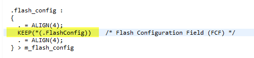

Jorge_Gonzalez
Hi Herve:
Yes, that file contains the section called ".FlashConfig" and this section should be referenced from the linker like this:
To verify the linker file used by your project you can go to Properties -> C/C++ Build -> Settings -> Cross ARM C++ Linker -> General:

- My linker file is "./Project_Settings/Linker_Files/ProcessorExpert.ld", and there is  the right section .FlashConfig as you show in your post.
- I have a file "./MQX_KSDK_1.0.0/platform/startup/MK64F12/gcc/startup_MK64F12.S" in which  the byte FSEC is equal to 0xFE
So everything seems to be good,
BUT
In my binary file the adresses 0x0000400 to 0x00000410 are all equals to 0.
Can you help me please?
