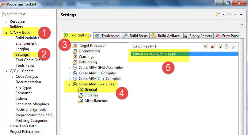

Where are the linker command files (i.e the ones that tell the linker were to put things in memory) ?

But there was no supplied BubbleApp project for KDS, so I tried (several times!) to make my own.  I told KDS I wanted to build a new project and copied the source files from one of the existing BubbleApp projects in my new project.  First I got errors because include files weren't found.  So I made them findable with some difficulties due the difference between  includes with quotes and includes with angle brackets.  Then I got undefined externals (e.g. debug_printf) so I found libraries where they were located and specified them.  Eventually I was told that my .text section couldn't fit in the region m_text.  When I went looking for something that specified what m_text was and where it was located I couldn't find any file that mentioned "m_text". And I couldn't find any file that looked like any linker command file that I am familiar with.  (I've been doing this stuff for a long time!  Most recently with TI MCU's and longer ago with Intel micros, always in 'C' and or Assmbley Language; and always with a smattering of PC software development)

the linker file *.ld is defined in linker setting. see where to find it:
