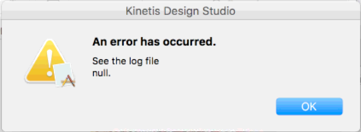

I've done a fresh install of KDS_v3 from kinetis-design-studio-3.2.0.pkg (on Mac OS X, of course! Smiley Happy).  When I launch it, it presents an error dialog:
An error has occurred.  See the log file null.
And though it may be unrelated, I see "MacOS error: -67062" messages in the console around the time I try to launch KDS.
I *can* launch KDS from the command line with the somewhat obscure command:
$ /Applications/KDS_v3.app/Contents/eclipse/kinetis-design-studio -configuration ~/workspace/.metadata/configuration
but I'd rather not have to do that every time.
I suspect some permission problem, or perhaps an outdated Java.  I also think I've read about this problem somewhere, but haven't been able to find the thread that describes it.

Officially KDS3.2 only support
  • Windows® 7/8/10 (32 and 64-bit)
  • Linux® 64-bit (Ubuntu 10.04 (deb), RedHat/Centos 7 (rpm))
  • Mac OS X (10.10 and 10.11) with SEGGER J-Link support
Officially we don't have full test on other higher version Mac OS.

Hi Jennie:
I frequently launch KDS_v3 on other systems running Mac OS X 10.13.1 without any difficulty, so I think this is some other problem.  This is why I believe it may be a problem with permission files.
Let me ask the question another way: when I launch KDS_v3 *without* the `-configuration` argument, where does KDS_v3 search for the metadata?
