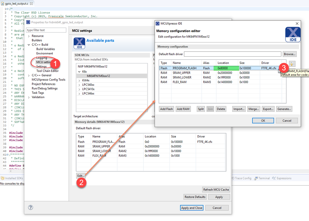

Hi Robert,
There is no need to modify the linker scripts to make your application usable with MCUBOOT, you can keep using the managed linker scripts fucntionality and just add an offset to the start of your application, you just have to open the project properties go to C/C++ Build > MCU settings and change the Flash start Location of your application:
Hope it helps!
Carlos Mendoza
Technical Support Engineer
Hi Carlos_Mendoza, I've done that step to relocate the application in PROGRAM_FLASH to the BL_APP_VECTOR_TABLE_ADDRESS (e.g. 0xA000 on my target or 0x8000 in your example). However, robertpoor's question is about defining a section to the application for the BCA (bootloader configuration area) in flash. Is there updated documentation for MCUXpresso that describes how to do this properly using the managed linker files? Everything I have found does not cover relocating data to FLASH or and doesn't handle the case for the Flash Config Block (section FlashConfig) at flash offset 0x400.
Relocating Code and Data Using the MCUXpresso IDE (https://community.nxp.com/docs/DOC-335283?comment...) from Alice_Yang only mentions relocating data into RAM for example.
