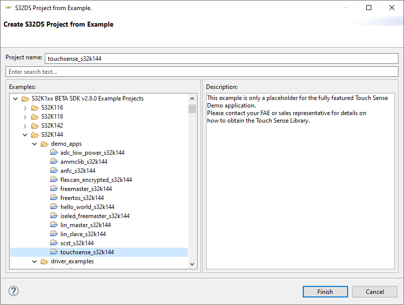

Hi, I am trying to implement touch function using S32K144 EVB.
I have an example file for implementing touch functions, but I have a question.
Annotating FMSTR_Poll(); from Main(); does not properly realize the touch function.
FMSTR_Poll() is a function of the FreeMASTER, so I don't know how it affects the implementation of the touch function.
I tried to analyze the FMSTR_Poll() function but failed to get the correct answer.
How can I implement touch function without a FreeMASTER?

iulian_stan
Hi alstlr926@naver.com‌,
Sorry for the late reply. In case you are interested in the touch-sense functionality only (without FreeMASTER), I would recommend checking the SDK examples first. File→New→S32DS Project from Example:
Please note this space is meant for FreeMASTER issues, in case you have platform or SDK specific issues you can address them in the corresponding spaces: S32K or S32 SDK.
