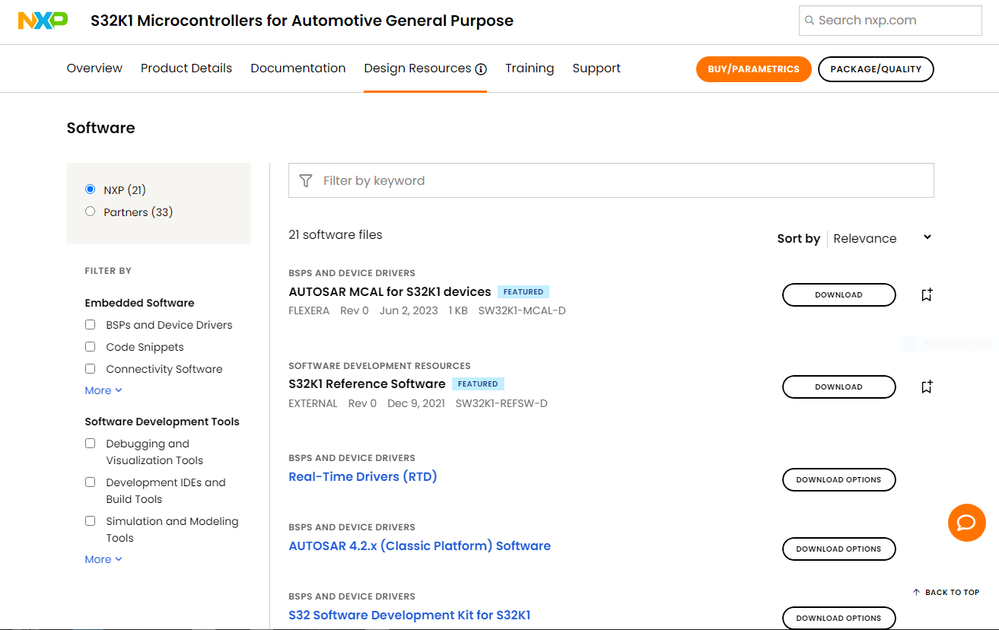

Coding_Torque-SDRS
Hi @iulian_stan The link you shared helped me in someway, but i'm still having issues in installing freeMASTER Communication Interface - I'm using S32K144EVB and S32K3 series EVB's but in select development board there is no option for selecting this board - Screen shot has been attached.
SDRS
1,059 Views
iulian_stan
Packages for automotive platforms (S32x) are not distributed via MCUXpresso SDK builder.
S32K1xx software support can be found on https://nxp.com/s32k1
In terms of FreeMASTER Driver, those can be found on https://nxp.com/freemaster
Note: S32 Design Studio is the IDE for automotive platforms.
