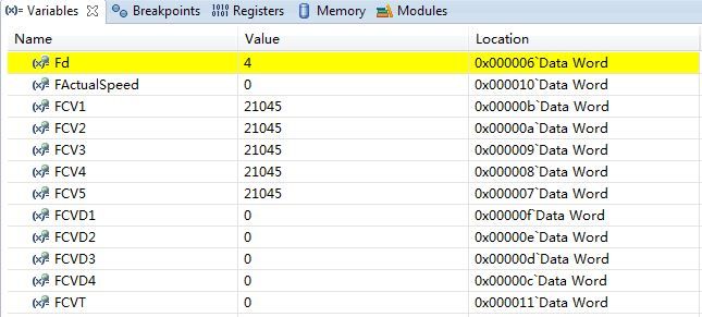

I am using the Capture Register in MC56F8006,and I want to capture a pulse.
But, I have some question.

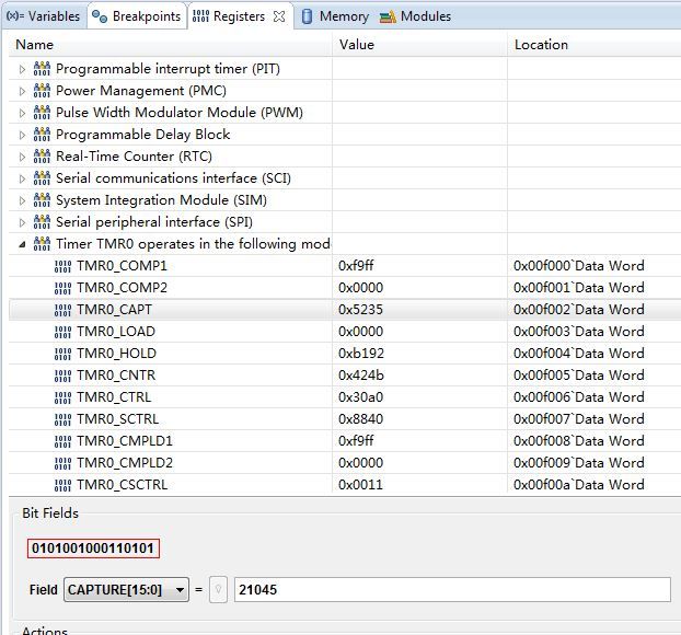

The data in Capture Register(TMRn_CAPT) don't change.
This is my program as follow:

CVT=CVD1+CVD2+CVD3+CVD4;
CVT=CVT/4;
for(;;){ }

/* TMR0_SCTRL:
TCF=0,TCFIE=0,TOF=0,TOFIE=0,IEF=0,IEFIE=0,IPS=0,INPUT=0,CAPTURE_MODE=0,MSTR=0,EEOF=0,VAL=0,FORCE=0,OPS=0,OEN=0 */
setReg(TMR0_SCTRL,0x0040);

int duty;
int d=0;
int CVT,ActualSpeed,CVD1,CVD2,CVD3,CVD4,CV1,CV2,CV3,CV4,CV5;
void TI1_OnInterrupt(void)
d=d+1;
if(d==1)
CV1=TMR0_CAPT;
if(d==2)
CV2=TMR0_CAPT;
CVD1=CV2-CV1;
if(d==3)
CV3=TMR0_CAPT;
CVD2=CV3-CV2;
if(d==4)
CV4=TMR0_CAPT;
CVD3=CV4-CV3;
if(d==5)
CV5=TMR0_CAPT;
d=0;
CVD4=CV5-CV4;
setReg(TMR1_CSCTRL,0x0041);
The debug result is:

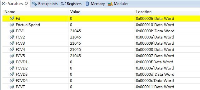

You can see the data in TMR0_CAPT don't change.
I want to count a speed. So I have to capture a pulse of speed.
Please help me.
Thank you very very much.

sutter_zhou
You should clear capture flag before each caption, which is IEF bit in SCTRL register.
