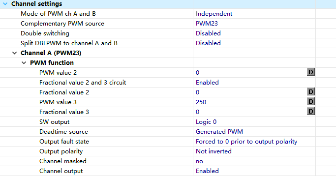

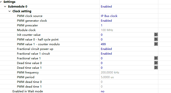

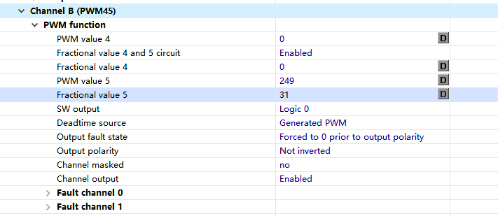

I'm debugging the fractional delay loigc of eFlexPWM of MC56F82748 using P&E mode. The configuration is as attached.
In theory, the duty cycle of PWM45 is closed to PWM23. However the duty cycle of PWM45 is neither closed to PWM23 when PWM_VALUE3 = 250 nor closed to that when PWM_VALUE3 = 249. Actually the falling edge of PWM45 is in the middle of PWM23 when PWM_VALUE3 equals 249 and 250. Is there any configuration wrong i neglected?Attached is the project i am debugging. thanks.

The fractional part can also be observed in the oscilloscope using my configuration. However the question is the fractional resolution seems not 1/32 of the PWM clock(100MHz) (ie. 312ps). For example, the observed actual duty cycle of (4+ 31/32) is much less than the duty cycle of (5+0/32) and the difference is much higher than 312ps.

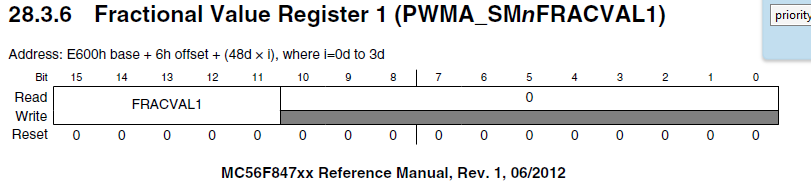

Do you pay attention that the bit 11_15 of PWMA_SMnFRACVAL1 register are valid?
