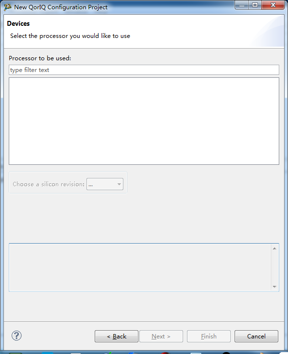

There is no  processor menus for choice while create a new Qoriq Configuration Project in CodeWarrior,what's the problem?
I have Installed Products:
 - CodeWarrior for Power Architecture
     Version: 10.5.1
     Build Id:160128
and
error Description:Processor Expert configuration file not found or corrupted (PE[_??].cfg).

I have the same problem, how to solve it?

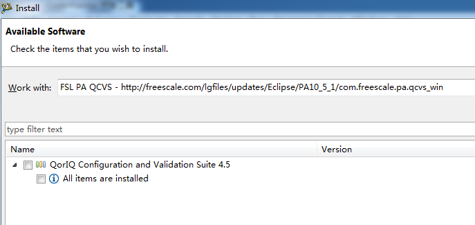

Please try whether it would be helpful to uninstall and install QCVS tool again.
Please select and uninstall "QorIQ Configuration and Validation Suite" from Help->Install New Software->already installed, then uninstall it step by step
Please install QCVS with the online method from Help->Install New Software->Available Software Sites, please select FSL PA QCVS, then click the drop down list at “Work with” to select “FSL PA QCVS", please select “QorIQ Configuration and Validation Suite 4.5” to follow the installation wizards to install QCVS tool step by step.
