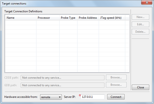

I'm trying to validate a custom board with a T2080 device.
From codewarrior I can connect to the board and I can access all registers of T2080 processor (LAW, IFC, DDR, ...)
But when I start QCVS in order to use DDR validation toos I get a error "can't connect to server!"
And when I open Validation tab no Target connection is available
I've a valid license for this product.
The CCS server  is working properly and detect CWTAP
Can tou help me?
thanks in advance.

Make sure you select Target access to localhost not remote. Also, try creating a new target connection.

When I select localhost, automatically changes to remote.
I can’t generate a new target connection, the button is disabled.

Try to use a new workspace.
