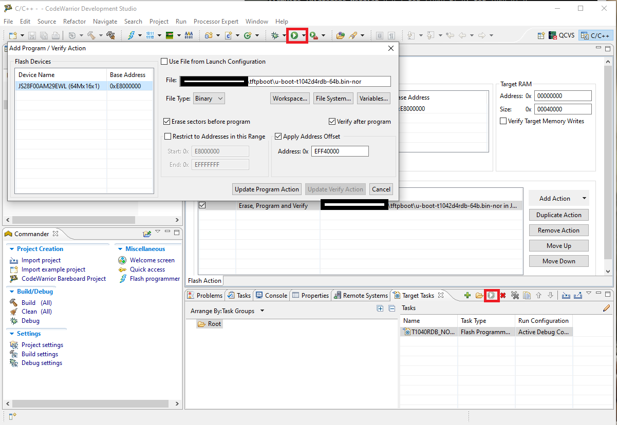

I am trying to burn new U-boot on T1042 D4 RDB as described in QorIQ SDK V2.0 - 1703 (Chapter 5) using Code Warrior for T1042. It's the latest Code Warrior Development Studio. I created a sample BareBoard project for T1042 D4 RDB.
I created a new Target Task as described in documentation but Execute command on Target Task window is not getting enabled. I can run project and I am having console logs.  Documentation says it gets enabled when the debugger is online. My Code Warrior Tab is working. TX/RX led is blinking green and RUN/PAUSE led is lighting red.
I attached Screenshots for more information. Console logs and disabled Execute button can be seen in these screenshots.
What is the reason of this situation, how can I solve it ?

Hello Ahmet Demir,
For flash programming, please refer to the step by step document Flash Programmer for CodeWarrior Power Architecture
1. First please create a board project with Download/Connect SRAM launch configuration.
2. Please import XML task template file for T1042D4 RDB, and add flash programing action in "PA Flash Programmer Task". .
3. Please connect to the target board from Run->Debug configuration -><project>-core00_SRAM_T1040_Connect->Debug, then the "Execute" button is available.
4. Please click "Execute" button to perform flash programming.
Yiping
