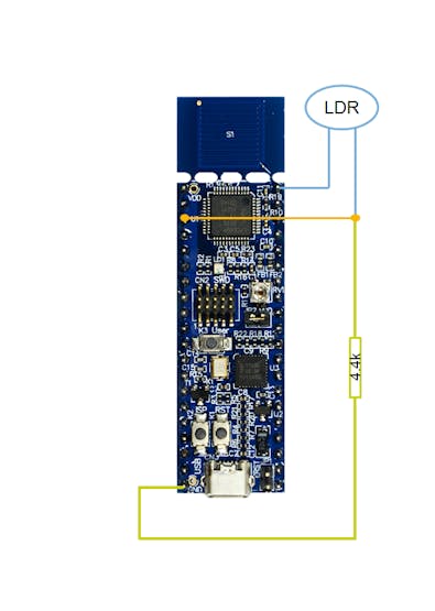

Using SDK drivers for LPC845 Breakout Board, this project measures the ambient light intensity by using LDR (Light Dependent Resistor). The voltage values from LDR are read through an ADC. The new LPC845 Breakout board has an SDK support which makes it a lot easier to interface an LDR for measuring light intensity compared to the conventional coding style. I have used the MCUXpresso IDE for modifying the pins and clock configuration settings.
The project requires a resistor and LDR (Light Dependent Resistor)/Photoresistor in a resistor divider circuit as shown below:
The value of R1 here is 4.4Kohm.
The output of this resistor divider circuit is connected to the assigned ADC channel. In this application, I have assigned it to the ADC0_8 channel which is the PIO0_18 (pin 3) and configured it accordingly in the software.
Components used: LPC845 Breakout Board, Light Dependent Resistor(LDR)/Photoresistor, 2.2Kohm resistor (Quantity:2)
LPC845 Breakout Board connections to the LDR are as shown:
LPC845   LDR
Pin Name Board Location Pin Name
ADC_8 PIO0_18 (CN1-3) resistor divider o/p
VCC CN1-40 LDR
GND CN1-20 4.4k resistor
For this application, I have used ADC0_8 as the ADC channel which converts the LDR output analog voltage values to digital values. The values printed on the console window reflect the change in the light intensity.
(For testing purposes, the light intensity can be changed by covering the LDR or using a cellphone flash)

/* ADC_CHN8 connect to P0_18 */
SWM_SetFixedPinSelect(SWM0, kSWM_ADC_CHN8, true);
The source code for this application and board info for the LPC845 Breakout board can be found here.
