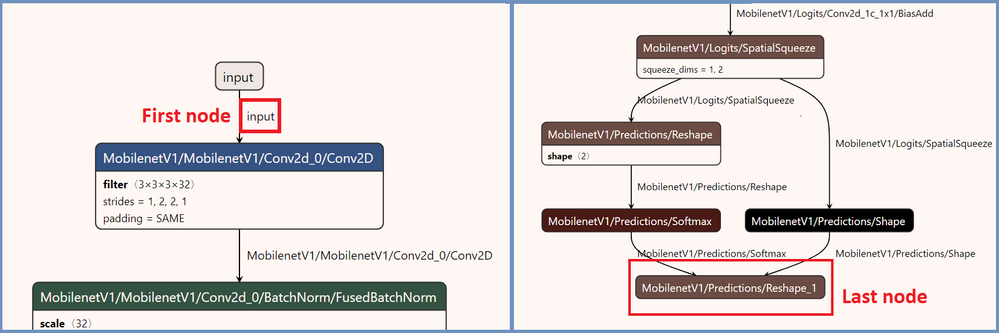

Method 2 - using netron GUI tool
Netron is a viewer for neural network, deep learning and machine learning models.
Install it on the Ubuntu host and use it to inspect the *.pb tensorflow frozen model:
$: pip install netron
$: netron mobilenet_v1_1.0_224_frozen.pb
Serving 'mobilenet_v1_1.0_224_frozen.pb' at http://localhost:8080
Open the specified page in the browser to visualize the graph and check the name of the first and last node:
