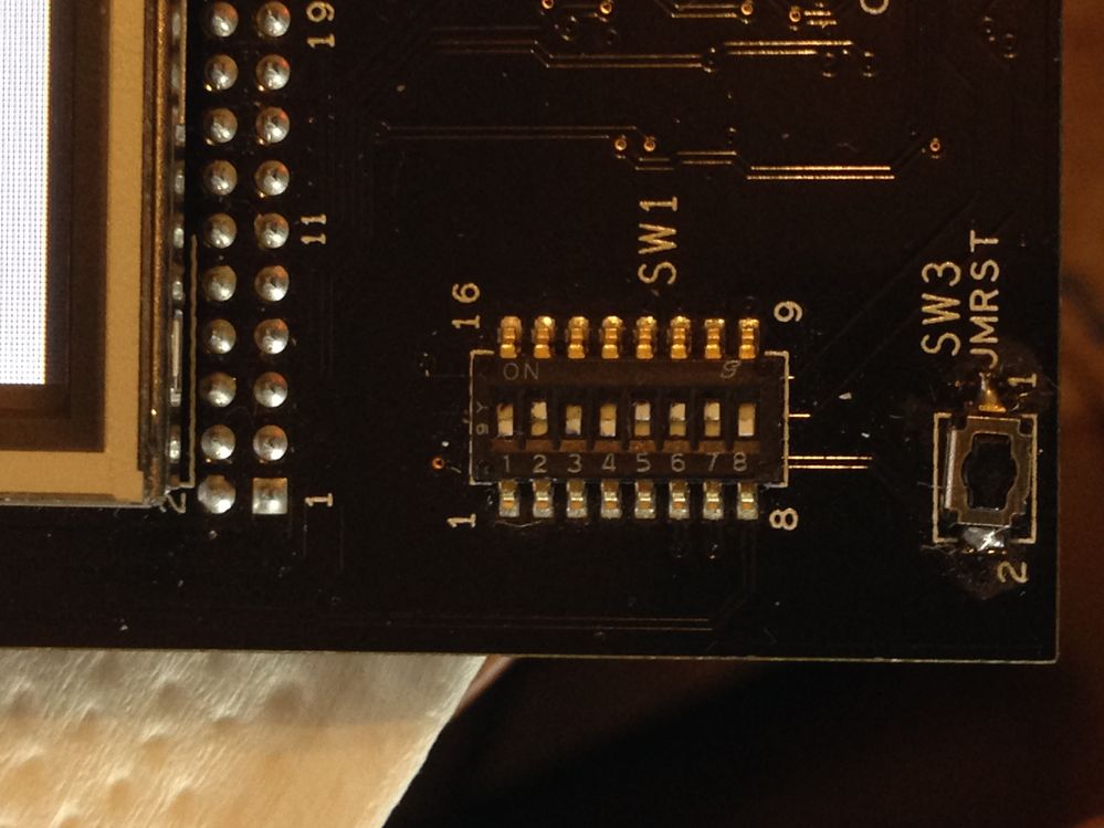

Hi, I'm trying to load official .s19 demo to my MCF51JM128 but only white screen appears. I can't use BDM cable and my SW5 settings are all right. How to fix it?

When you plug in USB cable, it is enumerating as USB MSD?  Do you see "Bootloader mode: waiting for S19 file..." displayed on LCD?
If yes to both please try using my "precompiled S19" files to test your display.
Here is my sw1 configuration for reference:
David
