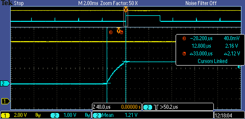

The code consists of 10 "stop" instructions in a row followed by a "check to see if should wake up" sequence. The following oscilloscope shows 4 short wakeups at 2ms intervals, followed by the long one (3ms) when it runs the check. Then it goes back to the short ones. The magnification is of the "long one" startup edge.
CGMXFCCGMXFC
The signal above is the CGMXFC signal on the CPU. That's the input to the PLL's VCO, and would seem to indicate that it takes 33us for the PLL to get back to running at the right frequency. I don't know what frequencies it is running at when CGMXFC is rising from zero.

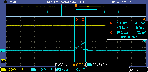

Here's one of the short ones. It is only getting to about half of the working voltage (and possibly frequency) before the running code drops into the next STOP instruction and the PLL shuts off again.
I think the above means that the CPU exits the stop mode and is then running on an unstable clock from the PLL. It isn't waiting for the PLL to be synchronized (as it managed to enter stop mode and disable it before it got fully on).

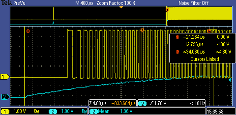

I've programmed the chip to emit The Bus Clock divided by 4 onto MCLK so I can see what that clock is doing. This is the same clock (or derived from the same clock) that the CPU is running from. It is programmed to run from the PLL with the resulting Bus Clock being 8MHz.
The BLUE trace is the CGMXFC pin. That's the pin with the filter on it that provides the voltage that runs the VCO. The Yellow signal is MCLK, which is BUSCLK/4 and so is normally 2MHz. The Blue signal can be seen taking about 30us to stabilize, at which point MCLK is now stable at 2MHz. The Blue trace starts rising when the previous STOP instruction is exited.

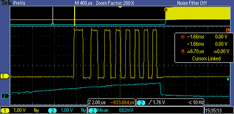

The following is exit from STOP followed by quick entry into STOP again. The clock starts out at about 550kHz and gets to 1.3MHz before the next STOP instruction.
If I set the oscilloscope to trigger on positive cycles less than 250us, I get it capturing 230us cycles, which corresponds to a bus clock of 8.7MHz. That means the PLL is overshooting the target frequency, and makes the CPU run faster than its specified maximum of 8MHz.
So running from the PLL when the PLL is stopped (and then starting) looks like a very bad idea.
