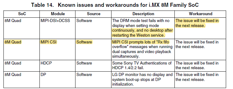

sect.Table 14. Known issues and workarounds for i.MX 8M attached
Release Notes describes issues with some monitors, so one can try others.
For running linux one can try to follow sect.4 Booting Linux OS Linux Guide,
try demos in folder /opt/imx-gpu-sdk/.
igor

  Thank you reply my question. I have seen the sect.Table 14. Known issues and workarounds in the Linux release Notes IMX8M mini Attached files
  the issues are listed as follows
   On above table, which means the 8M or 8M mini Quad will be fail with no display when setting mode in the DRM ?
but the 8Mmini has only the eLCDIF (MIPI-DSI) controller and without any DCSS, therefore, we have to use the MIPI2HDMI sub-board to debug
our work. If the display problem listed by the table 14 is exist, what can I do next step? please give me suggestion. thank you very much!

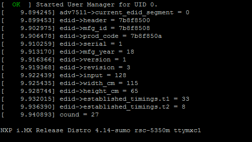

Anyway, I test the my PC screen (support FullHD HDMI and EDID ) today, the following scripts are printed:
when I cat the modes:
  $cat /sys/class/graphic/fb0/modes, the PC screen prefer resolution is 1360x768@60Hz
 (why here is 1360x768p-0 instead of 1360x768p-60? I don't understand !)
I add some resolution 1360x768 in the source code drivers/gpu/drm/drm_edid.c
static const struct drm_display_mode edid_cea_modes[] = {
   /* 108 - 1360x768p@60Hz 16:9 tony add 2019-06-20 */
{ DRM_MODE("1360x768", DRM_MODE_TYPE_DRIVER, 85500, 1360, 1424,
1536, 1792, 0, 768, 771, 777, 795, 0,
DRM_MODE_FLAG_PHSYNC | DRM_MODE_FLAG_PVSYNC),
.vrefresh = 60, .picture_aspect_ratio = HDMI_PICTURE_ASPECT_16_9, },
but it's not used! the PC screen is still turn black when the Linux kernel boot up
So what can I do ?
Thank you!
>but it's not used!
correct. Becasue hardware does not support other resolutions, except given
in struct drm_display_mode edid_cea_modes[].
>So what can I do ?
use monitor with standard "cea_modes" resolution.
igor
