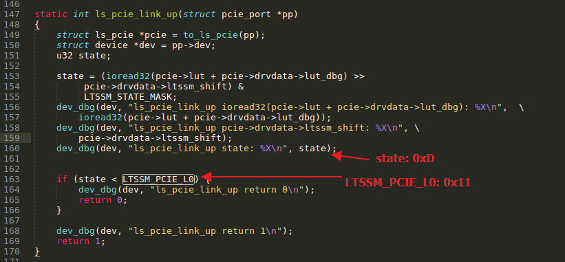

We added the PCI-E Switch(PI7C9X2G304SLBFDE) on our LS1012A dev board,
sometimes can't detected PCE-E Switch information after entering the file system,
Test ten times to boot, four times have the problems,
We debug ls1012a pci-e drivers, ls_pcie_link_up function returned 0, because state is 0xD < LTSSM_PCIE_L0,
How to fix this issue?
LS1012A LSDK version: 1803

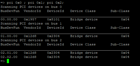

Log:
u-boot PCI-E info:
not detected:

can detected:
root@localhost:~# lspci -vvv
