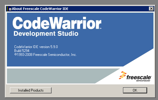

To investigate your problem, we need reproduce it first.
Please attach this information
1.    your CW version: Start the IDE and click on Help | About CodeWarrior Development Studio. Send me the version and build id.
2.    send the entire sample code folder(include .project, prm,c...) in zip format to me. so that i can test it on my side directly.
3.      error screenshot.
Thanks for your cooperation.

kimchan_eb
Q1:
Q2:

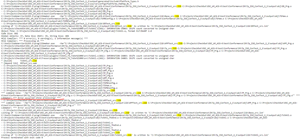

Q3:
It's a log with only the info with error.
make.exe: *** No rule to make target `C:\Projects\CheckOut\OSC_WM_ACG-6\test\Conformance\IN\Tp_ISO_ConTest_2_1\output\lib\APPTest_src.lib', needed by `C:\Projects\CheckOut\OSC_WM_ACG-6\test\Conformance\IN\Tp_ISO_ConTest_2_1\output\depend\APPTest_src.mak'. Stop.
make.exe: *** Waiting for unfinished jobs....
I don't know how to solve it because these infos are not enough for me. If checking the files locally, it's ok, though error on the build.
