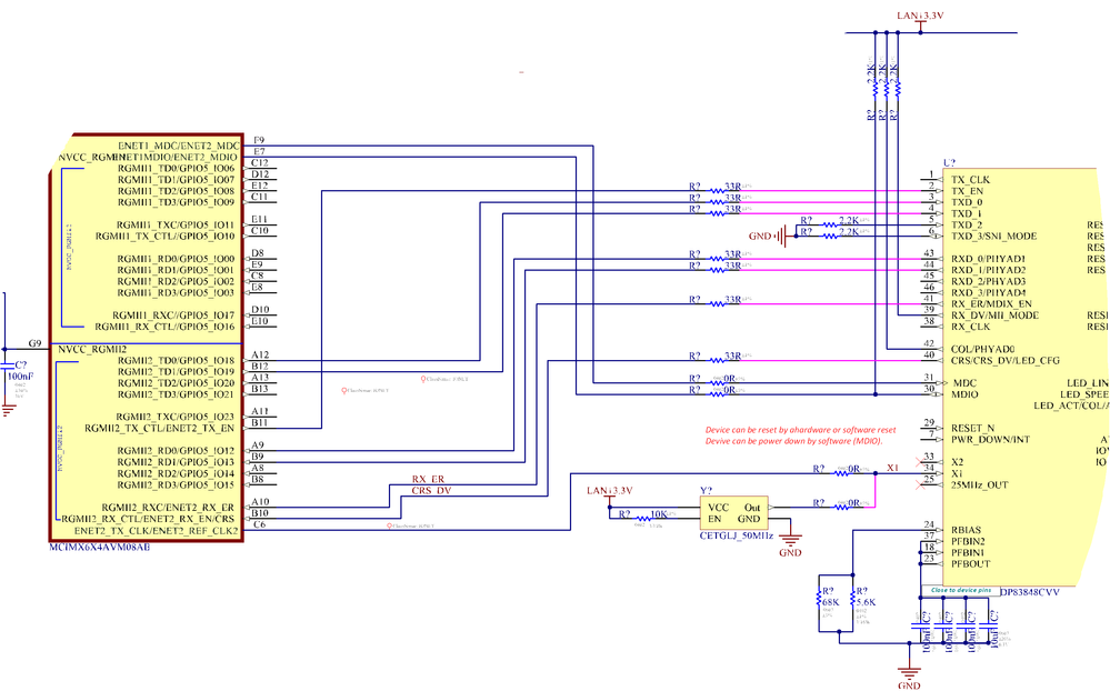

Hi everybody,
I am using imx6sx on a costume board i connected ethernet to ENET2 with RMII and externel oscillator.
what modification i should do on u-boot to get it work?
already I set the CONFIG_FEC_ENET_DEV = 1
and CONFIG_FEC_XCV_TYPE = RMII
the result in u-boot-imx and in u-boot-fslc is: build and run but no network!
could anyone please help
thanks

Hi Hui
one can check settings for external clock in IOMUXC_GPR_GPR1
which are defined in setup_fec() mx6sxsabresd.c
uboot-imx.git - Freescale i.MX u-boot Tree
igor

Dear Igor,
thanks for the answer, but i was not lucky!
here is the SCH of PHY and SOC:
i  use y-boot imx: and modified the FEC pin mux: this is part of board/freescale/mx6sxsabresd/mx6sxsabresd.c

would you please help.
thanks
