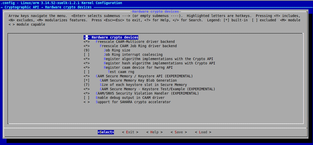

Hello, I'm trying to include and use the cryptodev module. I used this configuration
This is not enough to have /dev/crypto available? In my case it's not present.
My purpose is to run the text on CAAM with openssl test
openssl speed -evp aes-128-cbc -engine cryptodev
invalid engine "cryptodev"

I had compatibility problems, after kernel and fdt update I'm able to load the module. I have also another question linked to the usage of this module and dm-crypt (if some one tried this solution). Now that the module is loaded in /proc/crypto I can see available many caam driver, and if I use openSSL with this engine I can see an improvement in performances. But using dm-crypt with cryptsetup benchmark I don't see any performance improvements. Have some tips also on this ?
Thanks a lot again

Add the crypto-dev module to your image to enable OpennSSL call to the CAAM, adding next line to conf/local.conf:
-> CORE_IMAGE_EXTRA_INSTALL += "cryptodev-module cryptodev-tests”
And make sure your kernel Konfig is like bellow:
Kernel Konfig:
CONFIG_CRYPTO_DEV_FSL_CAAM=y
CONFIG_CRYPTO_DEV_FSL_CAAM_SM=y
CONFIG_CRYPTO_DEV_FSL_CAAM_SM_TEST=y
CONFIG_CRYPTO_DEV_FSL_CAAM_SECVIO=y
