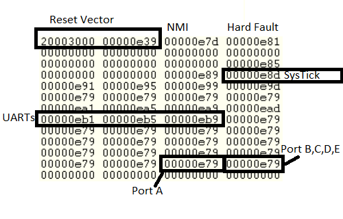

I checked your binary and can tell you the problem:
1. The Port and its interrupt (also in NVIC) is set up correctly.
2. The interrupt fires and its vector is taken, however you haven't installed the correct handler since it calls the "un-handled" interrupt which means that it hangs in the interrupt forever (with KDS you should have been able to see this too).
It is easy to see that the vectors are missing (you have VTOR set to 0 - meaning that the vectors are hard-coded - you will probably find them in an assembler file somewhere).
These are the values that you have in Flash starting at address 0x00000000. I have labeled the vectors of interest, including the location of the "port B,C,D,E" interrupt vector (the last one).
Since the vector value is the same as many others it is clear that a un-handled (default) vector is being used rather than one to handle the port interrupt.
If you can work out why and where you need to add it you should be OK. You will however need to ensure that the handler used is suitable for a port interrupt shared by these 4 ports or, in the worst case, one that at least handles the port C case for you.
As noted before, if you would prefer a more power ful and fool-proof solution just down-load the (free) Open Source uTasker project since it handles all such details.

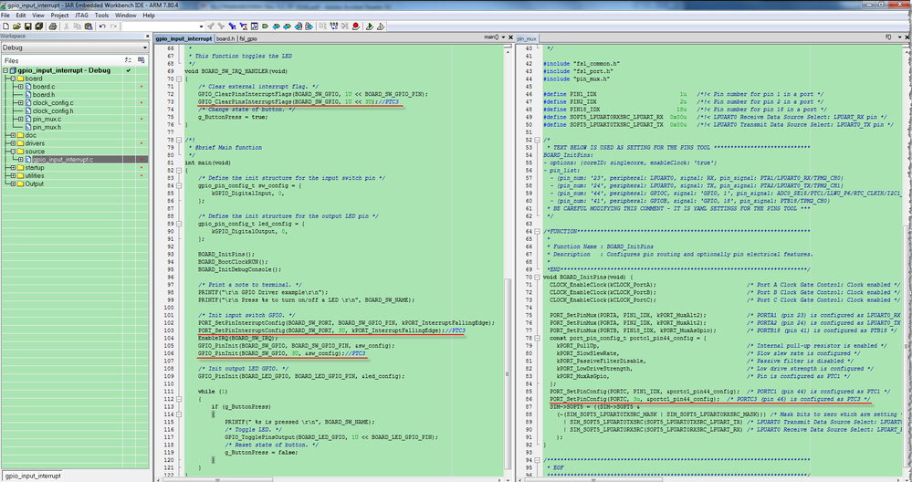

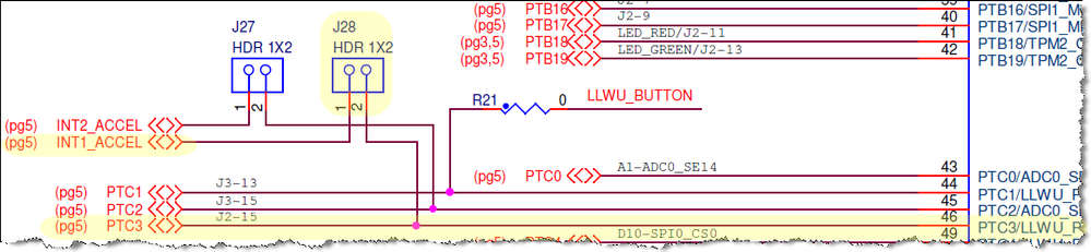

Robin_Shen
I am not sure if you have slove this problem.
You can refer the modification shown below:
Be notice that the PTC3 is connect to external signal through J18 by default.
Robin
