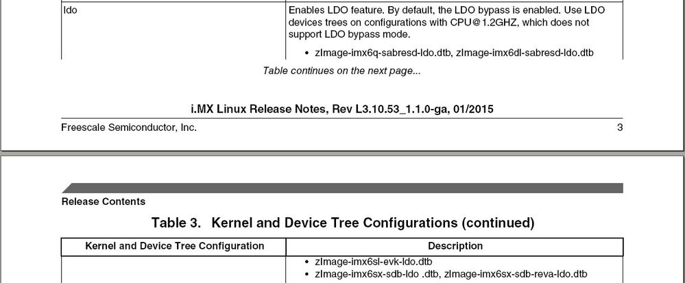

I believe latest releases use yocto and one can look at
Freescale Yocto Project main page
igor
