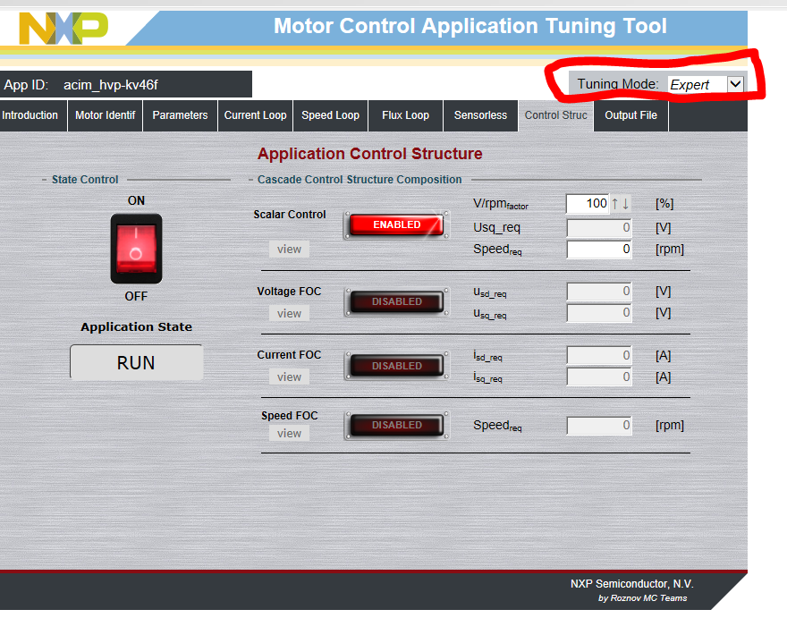

1.  I found that V/Rpm factor is accessible only in "Tuning mode = EXPERT" . Make sure that you have set MCAT in EXPERT tunning mode, becasue in BASIC tunning mode the V/Rpm factor is not accessible.

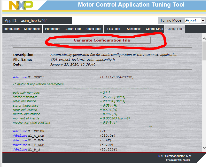

2. I found that if acceleration parameter is changed then you must click to "STORE DATA" and then switch to "OUTPUT FILE tab" and click to "generate configuration file" (this will generate new m1_acim_appconfig.h file beacause same calculation must be done in MCAT script to correctly set speed ramp) and then rebuild whole SW and load to MCU. Because if you change acceleration parameter and then click to "update_target" then the speed ramp variable in MCU is updated incorrectly.
The "UPDATE TARGET" feature will not be accessible for this acceleration parameter which needs other calculations in MCAT script, this will be fixed in next SDK release.

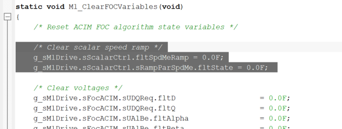

3. I found that if scalar required speed is set then, speed is ramping up and motor start spinning up (correct behavior). BUT if the speed is set to zero or some fault is generated and then new value of scalar required speed is set, then the speed ramp is not working and the motor is starting directly from zero rpm to required rpm without speed ramp. This is because speed ramp variables are not cleared if the motor stopped from previous run.
I know this is bug, but we will fix it in next SDK release. The workaround is the resetting of MCU  every time if new scalar required speed is set. Or you can fix this bug by adding this lines of code:
g_sM1Drive.sScalarCtrl.fltSpdMeRamp = 0.0F;
g_sM1Drive.sScalarCtrl.sRampParSpdMe.fltState = 0.0F;
and paste it into this function:
static void M1_ClearFOCVariables(void)
which is located in m1_sm_ref_sol.c file.

  1. Under the speed-loop tab of freemaster, I set the acceleration all the way to 2 rpm/sec and hit "update target" on that page.
  2. I then went to Control Struc tab, cleared the fault, changed "scalar control" to the bright red "enabled" [("V/rpm greyed out, Usq_req=0 (light grey color), and Speedreq=60rpm (white color)]
  3. I then changed the red toggle switch state control to "ON"
  4. The result is always a short spin-up of maybe 4 seconds at best and then a current fault.
  5. I've run this test repeatedly over and over trying various changes....e.g. Speedreq=300, 500, 700rpm and changing the motor parameters  In,Un,Fn parameters page and hit update target on that page. I notice if I take parameter  In down to 1 amp, Freemaster won't fault, will stay in the RUN mode, but the motor won't turn.

I suggest to try scalar control, this is open loop control without feedback. You can try this scalar control, but try it with slower speed ramp (you can change speed ramp (acceleration) in speed loop tab in freemaster) I think that you must click to "generate output file" in output tab and download SW with new parameters into MCU.
