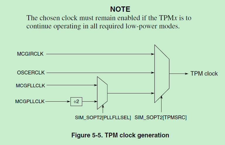

1. You should know your TPM source clock.
  From this picture, you can get that the TPM have four source clock: MCGIRCLK, OSCERCLK, MCGFLLCLK, MCGPLLCLK.
   Because I use the OSCERCLK 8Mhz, then the code is:

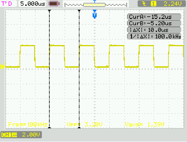

Besides, I also help you create a TPM KDS project, and test it on my FRDM-KL25 board, it can output 10us period edge aligned PWM in PTD0.
For the detail configuration, please  check my attached KDS project.
This is the test result:
Wish it helps you!
If you still have question, please let me know!
Kerry
