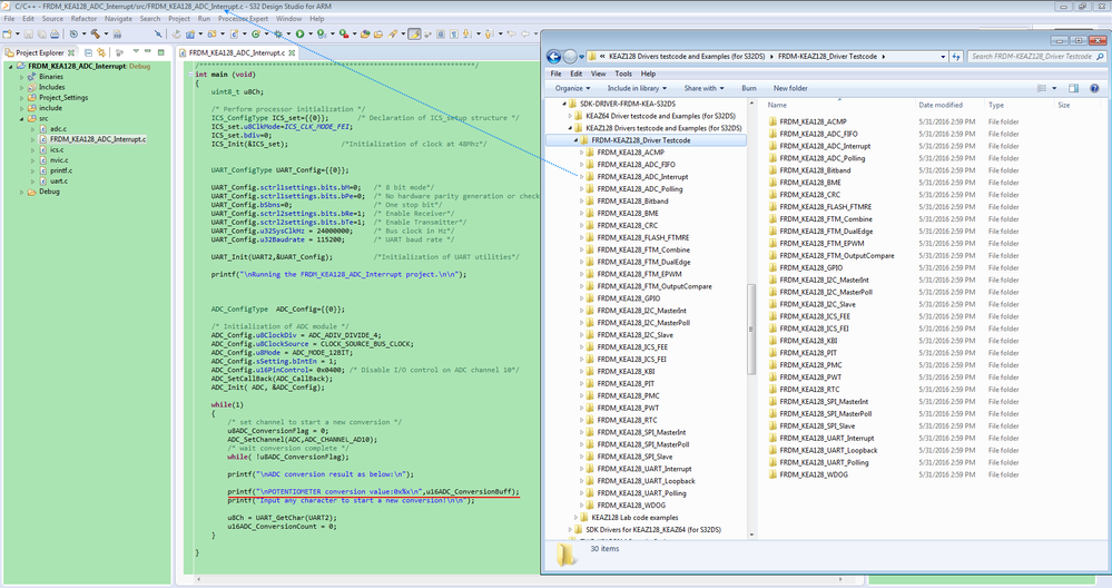

Could you explain in more details how to configure it? Because I have changed UART_Init(UART2,&UART_Config) to UART_Init(UART1,&UART_Config)  also I have tried  UART_Init(UART2,&UART_Config) to UART_Init(UART1,&UART_Config) but it is not working. Checking with scope on pins and its definitely not working.

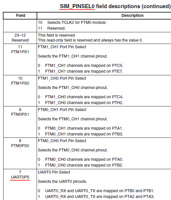

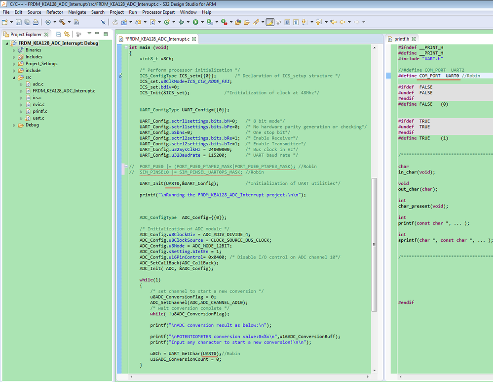

If you want the UART0 work, you need change like below:
in "FRDM_KEA128_ADC_Interrupt.c":
     UART_Init(UART0,&UART_Config);
     u8Ch = UART_GetChar(UART0);
in "printf.c":
     #define COM_PORT  UART0

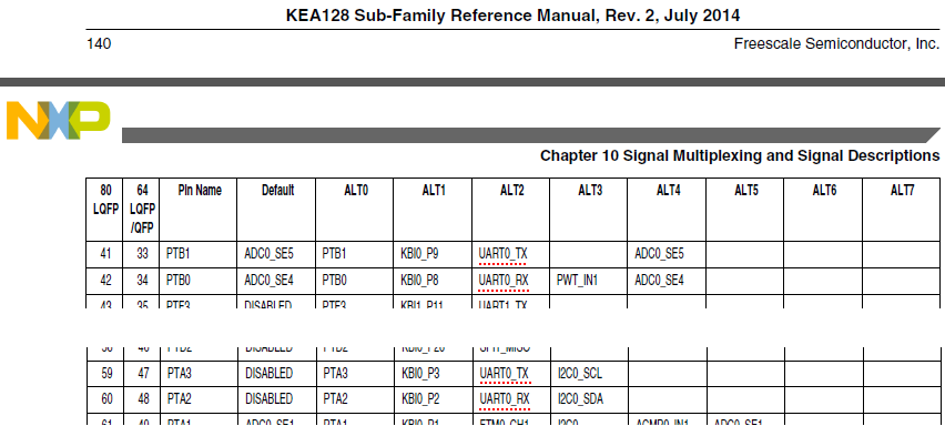

The UART0 and UART1 have two pairs of Pins, you can select them by using UART0PS of SIM_PINSEL0 and UART1PS of SIM_PINSEL1.

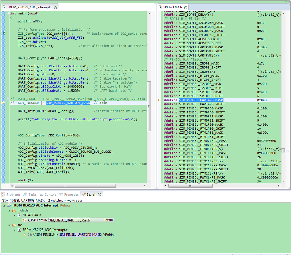

I do not understand library. In system_SKEAZ1284.h you can find:
#define SIM_PINSEL_UART0PS_MASK  0x80u
which means that PTA2 and PTA3 should be active, but  for me PTB0 and PTB1 is active (sends and receives data).  Can you explain me what I am doing wrong?

In SKEAZ1284.h I can find:
It does not mean that the default value of SIM_PINSEL_UART0PS is equal to 1.
If you want to use PTA2 and PTA3, please set the UART0PS bit in SIM_PINSEL and enable the internal pull up resistance.
