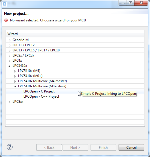

Step 1 - Create slave project
Go to either:
  • Quickstart -> New project -> LPC5410x -> LPC5410x Multicore (M0+ slave)
  • Quickstart -> New project -> LPC5411x -> LPC5411x Multicore (M0+ slave)
  • Select required project type (e.g LPCOpen - C Project) and click Next.

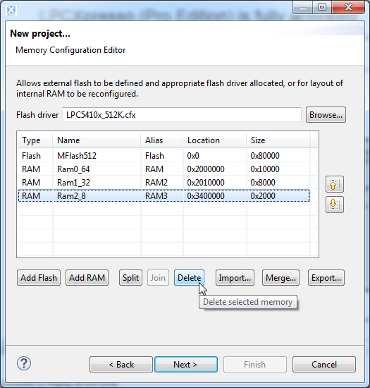

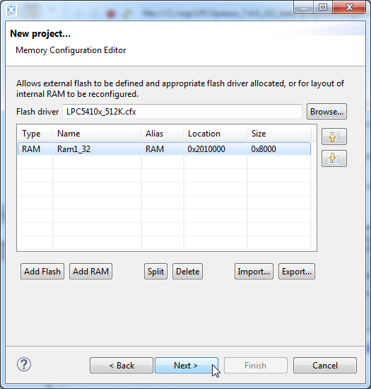

  • On the Memory Configuration Editor page, you should see the various memory blocks defined by default for the target MCU:
We need to modify the default memory map to only use the memory that will be used by the Cortex-M0+ (rather than the Cortex-M4).
  • Highlight the “MFlash512/ Flash” line in the table and click on the 'Delete' button.
  • Highlight the “Ram0_64/RAM” line in the table and click on the 'Delete' button.
  • Highlight the "Ram2_8/RAM2" line in the table and click on the 'Delete' button.
This should leave just the “Ram1_32/RAM2” line. This is the memory block that the Cortex-M0+ slave image will be executed from.
  • Then click through until you can click 'Finish'.

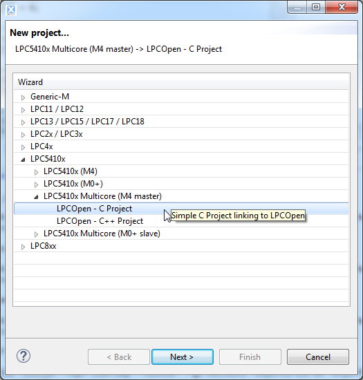

Step 2 - Create master project
Go to either
  • Quickstart -> New project -> LPC5410x -> LPC5410x Multicore (M4 master):
  • Quickstart -> New project -> LPC5411x -> LPC5411x Multicore (M4 master):

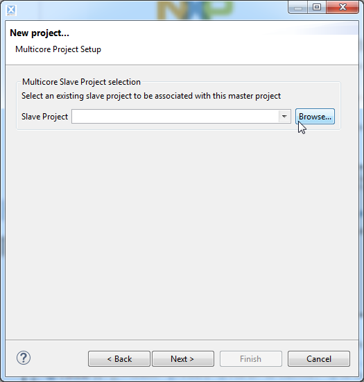

  • On 'Multicore Project Setup' page, use the 'Browse' button in the Multicore Slave Project selection box to select the Multicore M0+ project that you created previously:
Then click Next, then Finish.

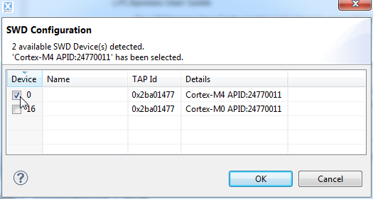

Start a debug session for Master project using the Debug option in the Quickstart view.
When prompted, select SWD target to connect to, which in this case is the one labeled in the ‘Details’ column as ‘Cortex-M4’:
Note that this setting will get stored in the project’s debug launch configuration, and so should be remembered between debug sessions.

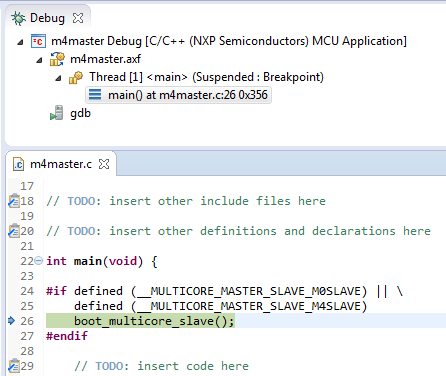

Having selected the appropriate core, LPCXpresso should download the executable containing both the Master and Slave images into the target MCU flash memory.

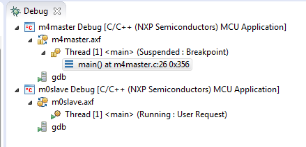

Once the connection has been made, you should hit the default breakpoint at the start of main() in the Master executable :

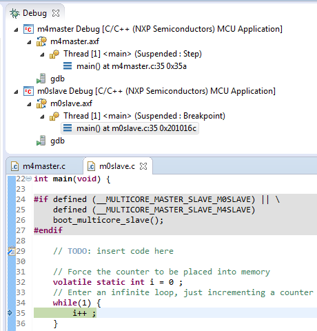

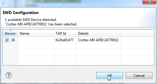

At this point, select the Slave project in the Project Explorer view, then use the Quickstart view Debug option to start a second debug connection.
Select SWD target to connect to. Note that as long as you have already connected to the M4, then the M0 slave should be selected automatically...
Note: In LPCXpresso IDE 7.6.2 and later, The Cortex-M0 will appear as Device 1, not Device 16.
LPCXpresso should detect that this is a Slave project and make an ‘attach only’ connection (and hence not download code and leaving the slave image 'executing').
Now step over the boot_multicore_slave() function in the master image, and the slave core will begin to execute, hitting the default breakpoint on it’s main():

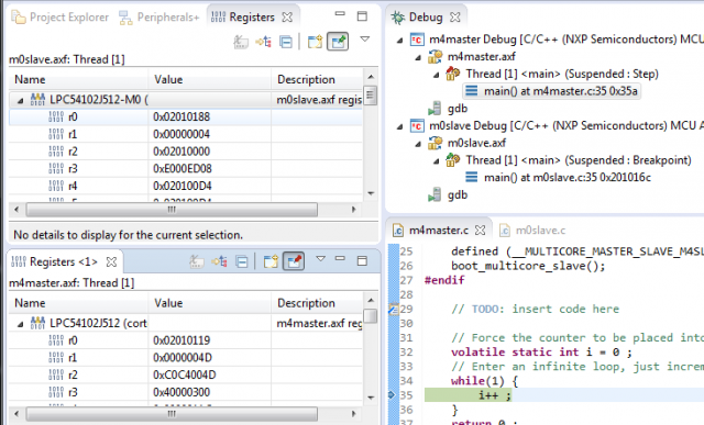

You can now debug both cores in parallel, selecting which core to step, resume, suspend, etc by switching between them in the Debug View.
Note: Although there is no debug logic synchronising debug operations on the two cores, you can select both applications at the same time in the Debug View (typically by using CTRL-Click) and operations like step, resume, suspend, etc will then be carried out on both cores by the debugger in parallel.

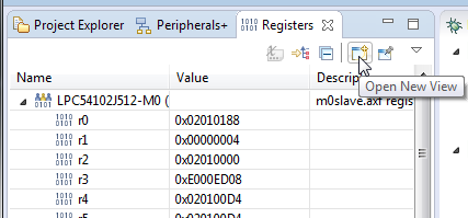

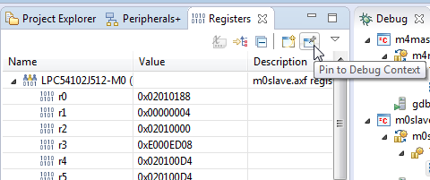

The currently selected core will be the one used for displaying many of the debug related views, such as Registers and Locals. It is also possible to create copies of many of the debug related views, and lock each copy to a particular core.
For example, to create two register views, one for the M4 and one for the M0+ ...First of all, use the “Open New view” button in the Registers view to create a second Registers view:
Now pin the original view to the core currently selected in the Debug, using the “Pin to Debug context” button :
Now select the other core in the Debug view, and go to the second Register view. Use this view’s “Pin to Debug Context” button to lock this second Registers view to the selected core:

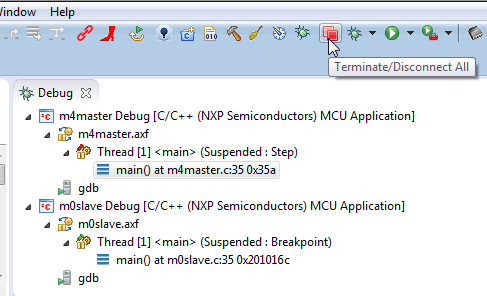

Note that when you have finished debugging, you can use “Terminate/Disconnect All” button on the icon bar to disconnect the debug connections to both the Master and Slave cores at the same time:
