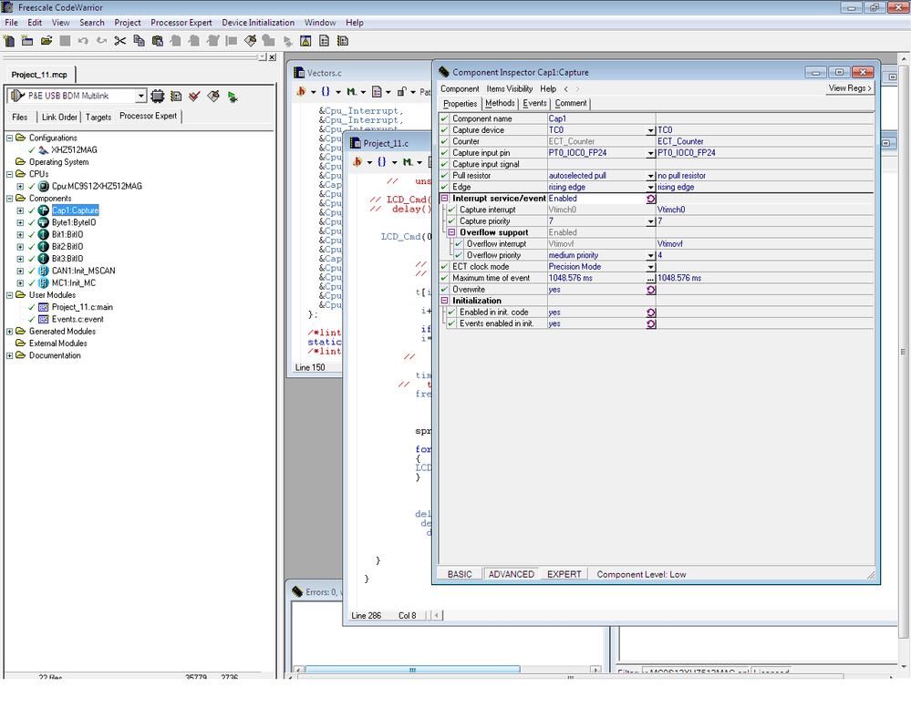

I am using Input capture mode of MC9S12XHZ512 for calculating frequency and duty cycle of square wave from 1KHz to 10KHz , I have attached image of setting i have done in codewarrior.
My problem is that when I try to display frequency on my LCD display I am getting random charter on , I also have problem with interrupt input capture mode I have enable input capture mode in codewarrior , but i'm not able to find it in program , I want to write my display and calculation code in interrupt sub routine of input capture mode. I have posted my code below.
I'm using 16MHz crystal
LCD_Cmd(0x80);
         //  TM=65535*(TC0/16000000);
         //  TM=1/TM;
         t[i]=TC0;
          i++;
          if(i==2) {
          i=0;
         time_interval=(t[1]-t[0]);
         time_interval=(float)(0.0000000625*time_interval);
         frequency= 1/time_interval;
         sprintf(buffer,"%d",frequency);
         for(j=0;j<5;j++)
         LCD_Data(buffer[j]);

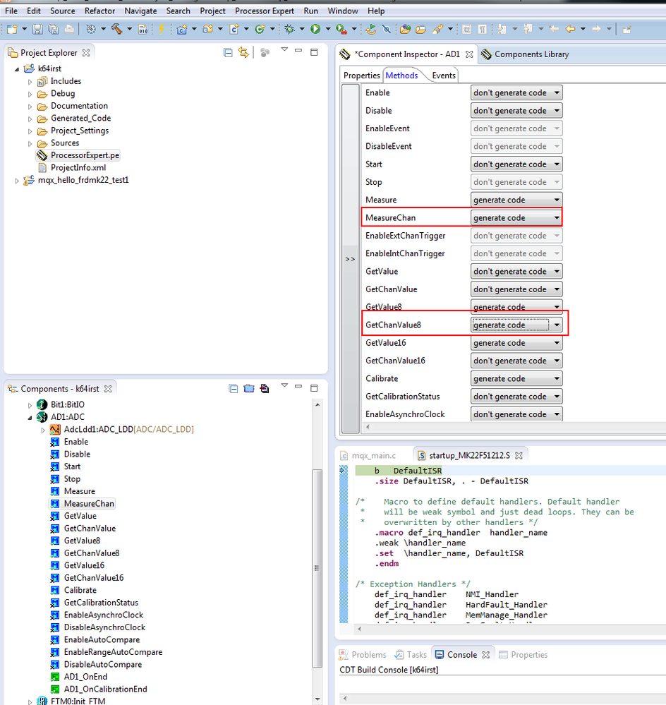

i am not a fan of the PE SW solutions.
i would like t show you how to measure frequency with own setup. I think you you understand how to set the PE then you are also able to set the registers yourself and you have everything under your control.
// Frequency Measurement
