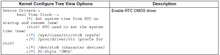

lunminliang
Below is copy from SDK 1.5 Infocenter, have you done that?
