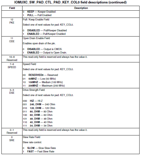

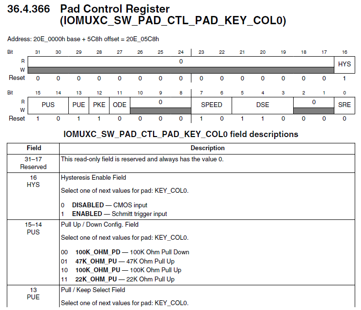

Hi All,
I am quite new to device tree i go through the imx6 linux BSP.
In file arch/arm/boot/dts/imx6q-pinfunc.h
I find some defination such as:
#define MX6QDL_PAD_KEY_COL0__UART4_TX_DATA          0x244 0x62c 0x000 0x4 0x0
mux_reg      0x244
conf_reg      0x62c
input_reg      0x000
mux_mode     0x4
input_val      0x0
But where to find this values in Datasheet. I am only able to find mux mode in Chapter 38 IOMUX Controller (IOMUXC)
38.3.127 SW_MUX_CTL(IOMUXC_IOMUXC_SW_MUX_CTL_PAD_KEY_COL0)
What about the rest. please help me out.
