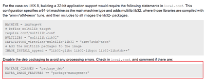

I am using the  IMX8 imx8mmevk from NXP.
My develop environment is yocto.
I can build the 64-Bit sdk and Linux kernel.
But if I want to build a 32-bit SDK, I am failed.
Please tell me the method, how to build a 32-Bit SDK for IMX8 imx8mmevk?
I have modify the build/conf/loacal.conf as below, but it still fail.why?
thanks.
require conf/multilib.conf
MULTILIBS = "multilib:lib32"
DEFAULTTUNE_virtclass-multilib-lib32 = "armv7athf-neon"
IMAGE_INSTALL_append = "lib32-glibc lib32-libgcc lib32-libstdc++"

Hi, yufangyong ,
Below is the descriptions in i.MX_Yocto_Project_User's_Guide.pdf
then try it.
Have a nice day!
