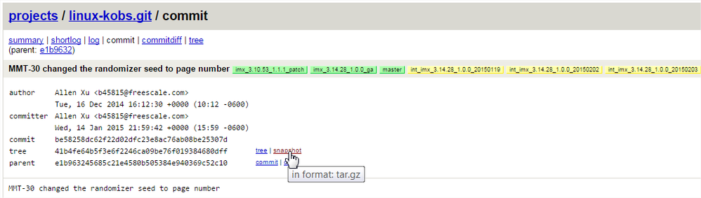

KOBS-NG
What you can do first is understand kobs-ng application, and try to understand it...sources are available on freescale's GIT:
http://sw-git.freescale.net/cgi-bin/gitweb.cgi?p=linux-kobs.git;a=summary
Anyway, the sequencing is not obvious...

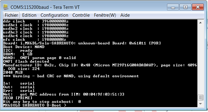

First configure your SABRE AI board:
S2: 0001
S1: 0001100000  (I use 8 BBT and FCB to be more secure)
BOOT_MODE: 0010 (if your NAND flash is not already programmed, otherwise 0100)

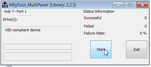

Copy my mfgtool (Works only with i.MX6 Solo part), and unzip it.
Plug  a micro USB cable and a RS232 cable, configure your hyperterminal as usual.
Launch mfgtool and press start:

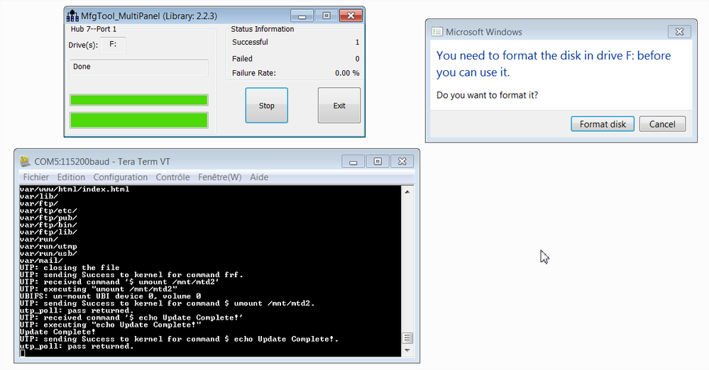

Wait the end of programmation:
Note: I did modify ucl2.xml file to have 8 BBT and FCB (see S1 configuration above, and "--search_exponent=3" --> 2^3=8 instead of default 2^2=4 ) and I did add the "-v" option in ucl2.xml file to have the verbose mode (thus memory addresses of FCB, BBT and more are displayed) ---> you have to go on the extreme right of the lines below... depending of the witdth of your screen):
<!--burn the uboot to NAND: -->
<CMD   state = "Updater"   type = "push"   body = "send"   file = "files/u-boot-mx6solo-sabreauto-nand.bin" > Sending U-Boot </CMD>
<CMD   state = "Updater"   type = "push"   body = "$ kobs-ng init -v --search_exponent=3 --chip_0_device_path=/dev/mtd0 $FILE" > Flashing Bootloader </CMD> ‍‍‍‍‍‍‍‍
Set BOOT_MODE switches: 0010 and press reset. After u-boot startup press a key in the terminal to stop execution.
Now you can explore your NAND!

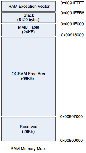

to read the NAND, I read it in internal OCRAM ( address is 0x918000 for i.MX6DL and Solo) and then I display it):
You can read the DCD of one of the boot image (first one is at address 0x400000 as you can see in the enclosed text file):

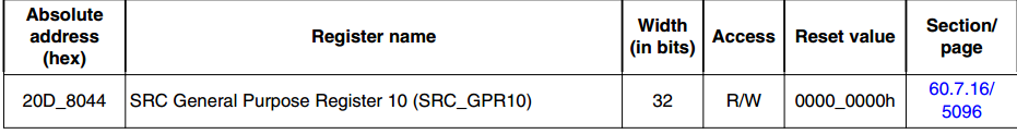

Let's check the persistent bit (i.MX6S or DL) PERSIST_SECONDARY_BOOT, reflecting from which image you boot:
MX6SOLO SABREAUTO U-Boot > md 0x20D8044 1
020d8044: 40000000    ...@
MX6SOLO SABREAUTO U-Boot >‍‍‍‍‍
Bit 30 is 0, meaning you boot from first image

MX6SOLO SABREAUTO U-Boot > nand read 0x918000 0x40000 0x800
NAND read: device 0 offset 0x40000, size 0x800
NAND read from offset 40000 failed -74
0 bytes read: ERROR
2048 bytes read: OK
MX6SOLO SABREAUTO U-Boot > md 0x918000 0x100

There is a typo there (it is "0", not "4" in red), comment is OK:
  1. MX6SOLO SABREAUTO U-Boot > md 0x20D8044 1
  2. 020d8044: 00000000    ...@
  3. MX6SOLO SABREAUTO U-Boot >
I cannot modify the previous text otherwise I destroy the page layout as it was written with a previous version of the community...
