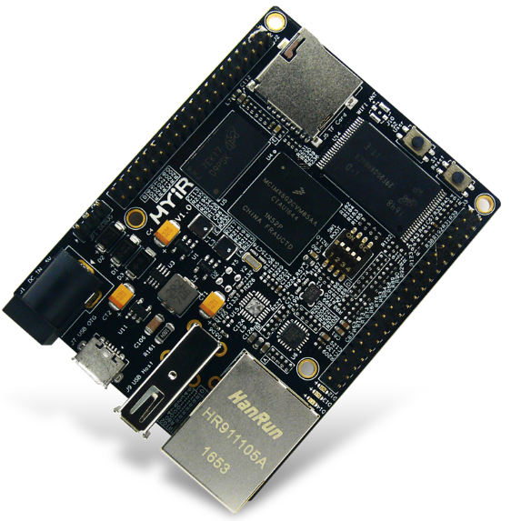

Measuring only 70mm by 55mm, the MYS-6ULX designed by MYIR is a high-performance low-cost Single Board Computer (SBC) specially designed for industry and Internet of Things (IoT) applications. It is based on NXP i.MX 6UL/6ULL processor family which features the most efficient ARM Cortex-A7 core and can operate at speeds up to 528 MHz.
The MYS-6ULX Single Board Computer supports Yocto and Debian OS. Here we take Debian OS as an example.

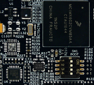

  2.      Power on the MYS-6ULX board. Insert the SD card to the slot, set the dip switch to 0101. Connect the serial port cable and USB power cable to the board, then power on the board.15.png

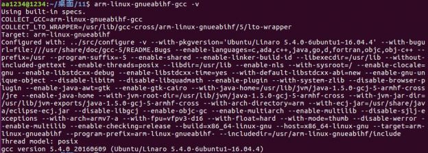

The develop environment I work on PC is Ubuntu VMS, ARMGCC compiler is needed to be installed in the Ubuntu VMS. We can check if the compiler is available with instruction arm-linux-gnueabihf-gcc–v. Ubuntu16 comes with a 5.4 version compiler as below:

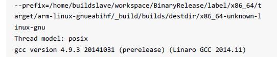

View the compiler version again, the information printed on the screen should be:
We can see the compiler version is 4.9.3. Then all the settings of develop environment has been completed.

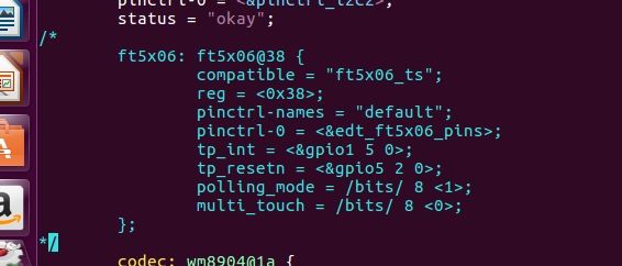

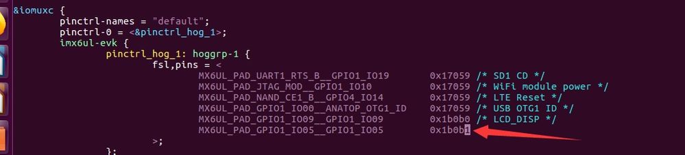

I have set up the development environment as mentioned. Could you explain how I could make an application to turn on/off GPIO_5 using Debian.
Thanks In Advance
Hi Prashan,
GPIO1_IO05 was originally used as the control pin for touch screen.
If you use it for other purposes, the touchscreen cannot use or reconfigure a control pin for the touchscreen
You need to modify  the kernel source code file “/arch/arm/boot/dts/myb-y6ull-14x14.dts” as below
Then compile and generate a new dtb file and programm it
Define GPIO in dts:
Mask out the original usage
