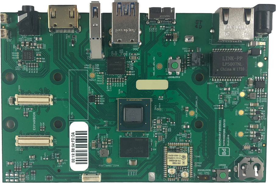

Boundary Devices is pleased to announce that its i.MX8M-based SBC Nitrogen8M is available and in stock!
Nitrogen8M specifications
The Nitrogen8M comes pre-populated with the most robust set of connectivity options available to allow for rapid development and validation of your next project. The boards are also be built with Boundary Device’s industry-leading, production-ready standards and include options such as industrial temp and conformal coating.
All this allows the Nitrogen8M to be used as an evaluation platform or production-ready solution. Review the full list of the specifications below. More information including pricing and availability can be found on the Nitrogen8M product page:
  • CPU — i.MX 8M Quad Core (x4 Cortex-A53 @ 1.5GHz; Cortex-M4 @ 266MHz)
  • RAM — 2GB LPDDR4 (4GB Optional)
  • Storage — 8GB eMMC (upgradeable to 128GB)
  • GPU — Vivante GC7000Lite
  • Camera — x2 4-lane MIPI-CSI
  • Display — x1 HDMI (w/CEC) and x1 MIPI DSI
    • several MIPI-DSI displays options available
  • Wireless — 802.11 ac and Bluetooth 4.1 BD-SDMAC Module (QCA9377)
  • Networking — Gigabit Ethernet port
  • Other I/O:
    • x3 USB 3.0 Host ports
    • x1 USB 3.0 OTG port
    • x3 I2C
    • x1 SPI
    • x3 RS-232
    • x1 SD/MMC
    • x1 RTC + battery
    • x2 PCIe (1 Mini-PCIE connector, 1 on expansion connector)
    • x1 JTAG
  • Power — 5V DC input
  • Operating Temperature — 0 to 70°C (Industrial Optional)
  • Operating System — Yocto, Ubuntu/Debian, Buildroot, FreeRTOS (M4 Core), Android
