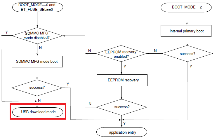

The USB download mode feature provides a means to load a software image to the target using the Serial Download Protocol (SDP). This feature is available on i.MX 7ULP CA7 ROM and is also used as a recovery mechanism after all possible boot paths have been exhausted.
The image below is an example of serial downloader feature usage in SD/MMC Manufacture Mode, after failing all boot attempts the target enters in USB download mode enabling users to recover the device.
Fig 1. SD/MMC Manufacture Mode boot flow
