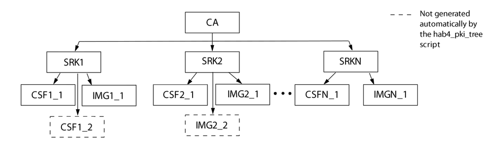

1. Background
The HABv4 in Boot ROM allows users to store up to 5 public keys (1 SRK, 1 CSF Key, 3 IMG Keys) to Key Indexes which can be used to authenticate boot images. The current implementation of hab4_pki_tree.sh script generates a basic PKI tree that contains up to 4 SRKs with a single CSF key and IMG key per SRK. If necessary users can generate additional keys using OpenSSL or add_key.sh script.
In the default configuration, HAB installs SRK in slot 0, CSF Key in slot 1, and IMG Keys in slots 2-4. Users can store additional IMG keys in the remaining slots by adding an Install Key command in CSF.
- Key Index 0 = SRK Table
- Key Index 1 = CSF Key
- Key Index 2 = IMG Key
- Key Index 3 = IMG Key (Optional)
- Key Index 4 = IMG Key (Optional)
In HABv4 it is possible to include up to four SRKs in a signed image, although only one SRK can be used per reset cycle. Additional IMG keys must be generated from the same SRK.
When HAB processes the Install Key command it verifies the Target Index, copies the key to respective Key Index in OCRAM HAB Persistent Memory Region, and validates the Key against the SRK defined in the Verification index.
