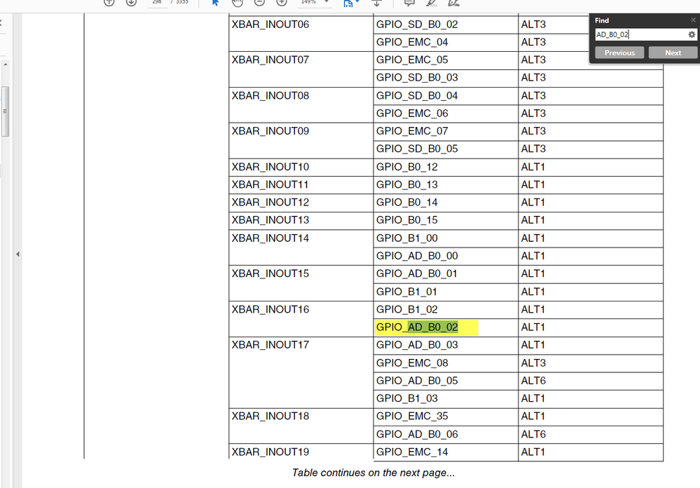

senthilnathan_n
Hello Kerry,
  Thanks for your quick feedback : From my use case .AD_B0_02 want to use as input capture, i want to capture the every raising edge of external pulse which appears in AD_B0_02 pin.
in normal scenario non of the QTIMER is not connected with AD_B0_02 pin, if i want to use AD_B0_02 pin as input capture the only option is XBAR.
hence i am trying to connect AD_B0_02 with QTIMER by using XBAR options.
I am new to the XBAR hence i don't have idea about XBAR connection for AD_B0_02 pint for input capture.

kerryzhou
It's very strange, my reply to this post is been migrated to a new discussion post, then I just copy it back to your post:
Hi  senthilnathan nagarajan,
   Thanks a lot for your description, now I understand your background now.
   You want to QTIMER4_timer1 channel as the input capture function, and the input capture pin is GPIO_AD_B0_02, but the QTIMER doesn't have that pin as the input capture pin. So you want to use the XBAR module to connect GPIO_AD_B0_02 pin as the capture input pin.
  OK, actually, you can use XBARA1 module.
input: IOMUX_XBAR_INOUT16 XBAR1_IN16
ouput: XBAR1_OUT99 QTIMER4_TIMER1
Please check these information:

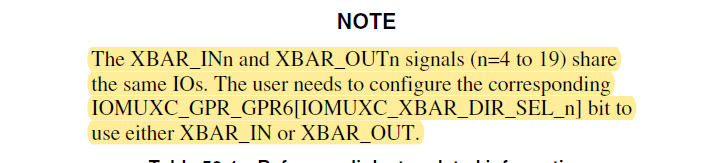

XBAR1_IN16 is the GPIO_AD_B0_02, alt1.
But this signal share the same IO as XBARA_OUT, you need to configure teh IOMUXC_GRP_GRP6 to set the input.
I have checked it, the default mode is the input mode, so you can use it directly.
Now, you need to add these codes:
