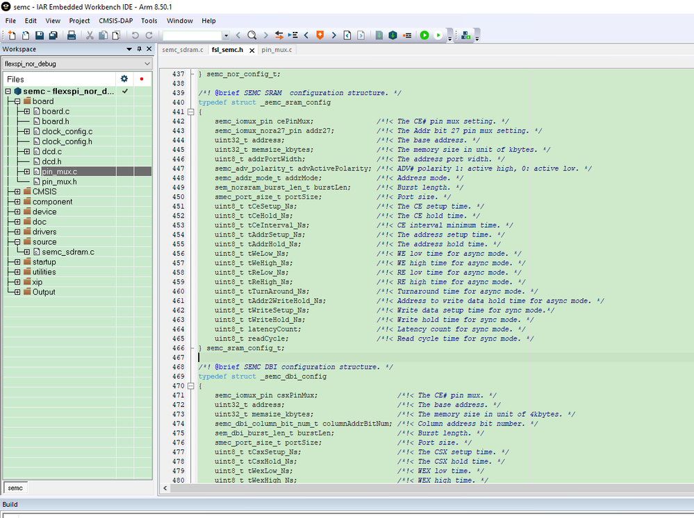

Dear Sir:
Have any SEMC for PSRAM driver sample code can reference?
1 返信
1,385件の閲覧回数
kerryzhou
Hi Tim Tan ,
 About the SRAM SEMC code, you can refer to the SDK SDRAM code:
SDK_2.8.0_EVK-MIMXRT1020\boards\evkmimxrt1020\driver_examples\semc\sdram
  In this code, we already defined the SRAM structure, you can refer to the SDRAM and your SRAM chip to fill the related code, you also need to modify the related pin configuration by refering your own hardware connection.
SDK code can be downloaded from this link:
https://mcuxpresso.nxp.com/en/select
Please check the SDK code on your side.
If you still have questions about it, please kindly let me know.
