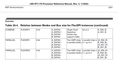

This implementation seems to be the way to go. You can take advantage of the 2 FlexSPI interfaces that the RT1170 has. This way, you can connect the QSPI memory to one FlexSPI and the HyperRAM to the other one. It's not possible to connect 32-bit or 64-bit memories through the FlexSPI interface. In section 30.3.1 of the reference manual, you will find the connections that you can make in a FlexSPI interface.

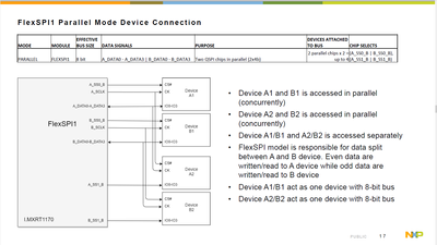

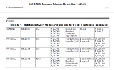

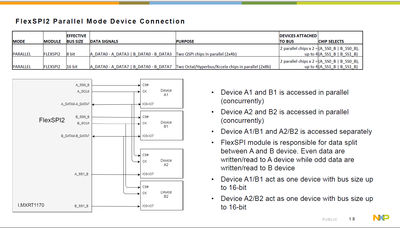

I found the document<IMX-RT1170-CROSSOVER-MCUS-FLEXSPI-CONTROLLER by Martin Lapis>. It is like a detailed statement for section 30.3.1 of RT1170 Reference Manual.
So, it can be accessed to 16bit data bus if two HyperRAM connect with FlexSPI2. Or up to 4ea HyperRAM chips connect with FlexSPI2 to make more capacity but only access to 16bit data bus maximum.
QuadSPI flash or OctalSPI flash connects with FlexSPI1 as normal and we can get the best preformation.
