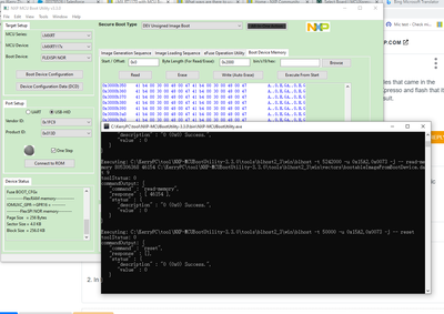

I am trying to use the NXP MCU Boot Utility to flash the i.MX RT1170. I am able to connect and flash the example files that came in the apps\NXP_MIMXRT1170-EVK_rev.a folder however when I try to build one of the examples from the SDK in MCUXpresso and flash that it "flashes" without error but does not work, and appears to just not boot. I have tried bin, hex and s19 files all with the same result.

Yes, sorry for the confusion the binary files( .bin, .hex and .srec) that come with the MCU Boot Utility are working. My issue is when I try to use a binary file that is generated by the build process in MCUXpresso. Here is my process perhaps I am missing a step.
1. I imported the evkmimxrt1170_hello_world_demo_cm7 example from the SDK into MCUXpresso. I also compiled and uploaded it with MCUXpresso to confirm that it works as expected.
2. Run Build on the project to generate the .axf file
3. In MCU Boot Utility immediately after flashing the working examples I boot the board back into serial downloader mode. I then change the Application Image File to the .axf generated above and they type to ".out(axf) from MCUXpresso" and run the "All-In-One Action" the runs to completion and posts no errors. I then reset the device and set it back to boot from flash.
At this point the board does not print hello world as would be expected but it also does not have the blinking light as it did before flashing so I know something is happening.
I have tried the above using .hex .s19 and .bin files all generated from the .axf using the context menu in MCUXpresso.
I have also tried using other examples from the SDK with identical results.

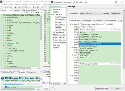

   Please in your SDK project, set:
XIP_BOOT_HEADER_ENABLE=0
Then generate the .s19 file, and download it again, you will find it works.
The MCUBootUtility need to use the app without the header.
The attachment is my generated .s19 file, you also can try it.
