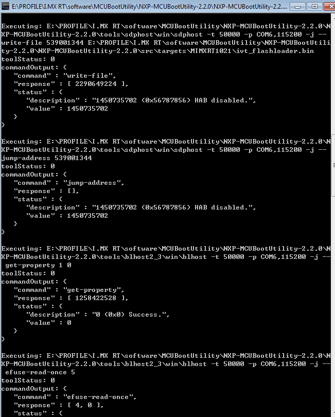

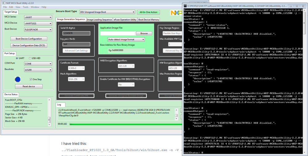

Hi rshipman ,
Do you want to download the code to the MIMXRT102-EVK QSPI flash?
If yes, I highly suggest you use the MCUBootUtility tool to download it.
If you want to know the detail blhost, sdphost operation, you also can check the MCUBootUtility command process about it:
You can download the MCUbootutility tool from this link:
https://github.com/JayHeng/NXP-MCUBootUtility/archive/v2.2.0.zip
the related user manual is:
If you still have questions about it, please kindly let me know.
Wish it helps you!
Kerry
