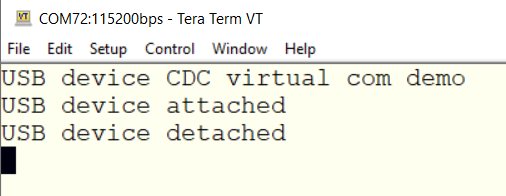

Hello Stefan,
I am sorry for the late reply. I am not sure what SDK project are you referring but I will take dev_cdc_vcom_bm as an example.
First you need to enable detach feature by setting the following define in usb_device_config.h file.
/*! @brief Whether the device detached feature is enabled or not. */
#define USB_DEVICE_CONFIG_DETACH_ENABLE (1U)
This will enable notification to the device callback through USB_DeviceAttachNotification and USB_DeviceDetachNotification functions.
#if USB_DEVICE_CONFIG_DETACH_ENABLE
        case kUSB_DeviceNotifyDetach:
            status = USB_DeviceDetachNotification(handle, message);
            break;
        case kUSB_DeviceNotifyAttach:
            status = USB_DeviceAttachNotification(handle, message);
            break;
#endif
Now you can implement what you like to do in USB_DeviceCallback when this events occurred. I just print message in console.
usb_status_t USB_DeviceCallback(usb_device_handle handle, uint32_t event, void *param)
 usb_status_t error = kStatus_USB_Error;
 uint16_t *temp16   = (uint16_t *)param;
 uint8_t *temp8     = (uint8_t *)param;
 switch (event)
 case kUSB_DeviceEventAttach:
  usb_echo("USB device attached\r\n");
  break;
 case kUSB_DeviceEventDetach:
  usb_echo("USB device detached\r\n");
  break;
I hope this helps!
