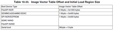

Q2. In reference Manual, it say that FlexSPI Configuration Block offset is 0x400.
But IVT is request same offset 0x400 for serial SPI boot.
How do I assign it correctly?

FlexSPI Configuration Block (FCB, aka FDCB) is used to configure FlexSPI peripheral, so it is needed by both NOR and NAND device.
Firmware Configuration Block (FCB, aka NFCB) is used to describe NAND device and bootable image info (IVT is part of bootable image), it is needed by NAND device only. but note that FDCB is part of NFCB for NAND
For FlexSPI NOR:
FDCB - offset 0x400
IVT - offset 0x1000
app image - offset specified by IVT
For FlexSPI NAND:
NFCB - first page of NAND first good block
bootable image - address offset specified by NFCB
IVT - offset 0x400 in bootable image range

The Flash Configuration Block (FCB) in AN12238 is FlexSPI Configuration Block (flexspi_nor_config_t).
For i.MXRT1060/1050/1020/1015, FCB offset is 0x0. For i.MXRT1170/1010, FCB offset is 0x400. (this change is caused by security peripheral upgrade BEE -> OTFAD)
AN12238 is mainly for i.MXRT1060/1050/1020/1015, as i.MXRT1170/1010 had not yet been released when this AN came out
3,527 Views
takayuki_ishii
Hello Jay_heng,
Thank you for your quick reply.
I understand that Flash Configuration Block (FCB) == FlexSPI Configuration Block.
Ishii.
